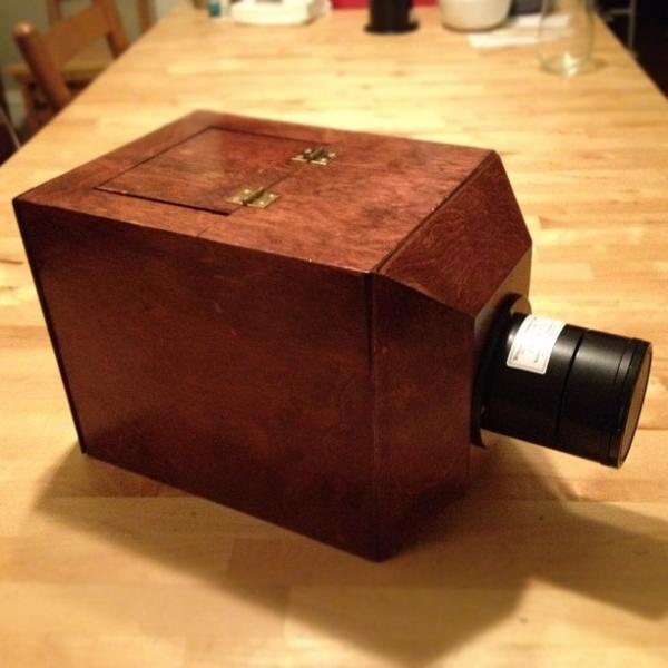

i just started making 4x5 sliding box, chamfered front cameras. The plan is to start offering them for sale as a complete finished camera and as a kit.
This one is made from hardwood plywood so the materials are not that expensive.

looks pretty good there--does it slide out the front? what's inside "the door" on the top?

"looks pretty good there--does it slide out the front? what's inside "the door" on the top?"
the back slides in and out to focus. the door on top opens to access the focusing screen and where the plate/film holder goes. I made this one to take a wet plate holder as well as a film holder. it works pretty good and looks great if your into the old style.
no movements though.
