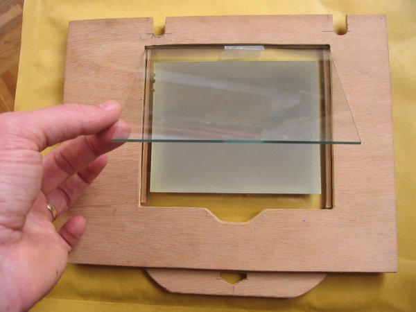

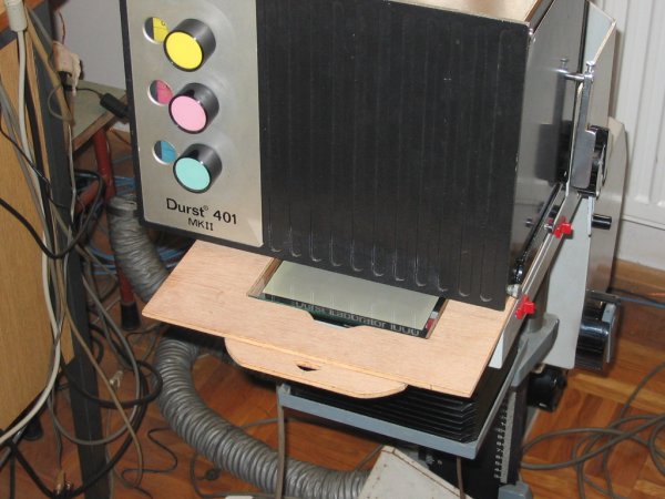

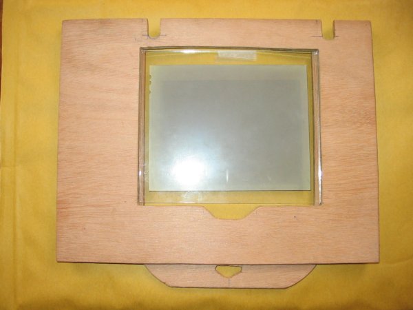

I got a beat up Laborator 1000 (see the story (there was a url link here which no longer exists)), but it came with a glassless neg. carrier for 9x12 format (i.e. cropped 4x5).
Wanting to enlarge full frame, I thought about making my own carrier out of matboard or something, but finally settled on a glass neg. carrier in a plywood "frame".
I used 6mm plywood, cut a hole for the glass, and intend to use two sheets of glass with a simple sticky tape (or gaffers tape) hinge.
I'll use ordinary glass, and if I notice any Newton rings, I'll use a "mat glass" for the upper sheet. I found some kind of "mat glass" at the local glass shop, used for "anti-glare" picture frames. It's a bit different from my Meopta AN glass, but I think it should do OK.
The attached photos tell the whole story :smile:
BTW, the plywood will be spray-painted in mat black, of course... This is just a fit-test, not the final product.
Denis
