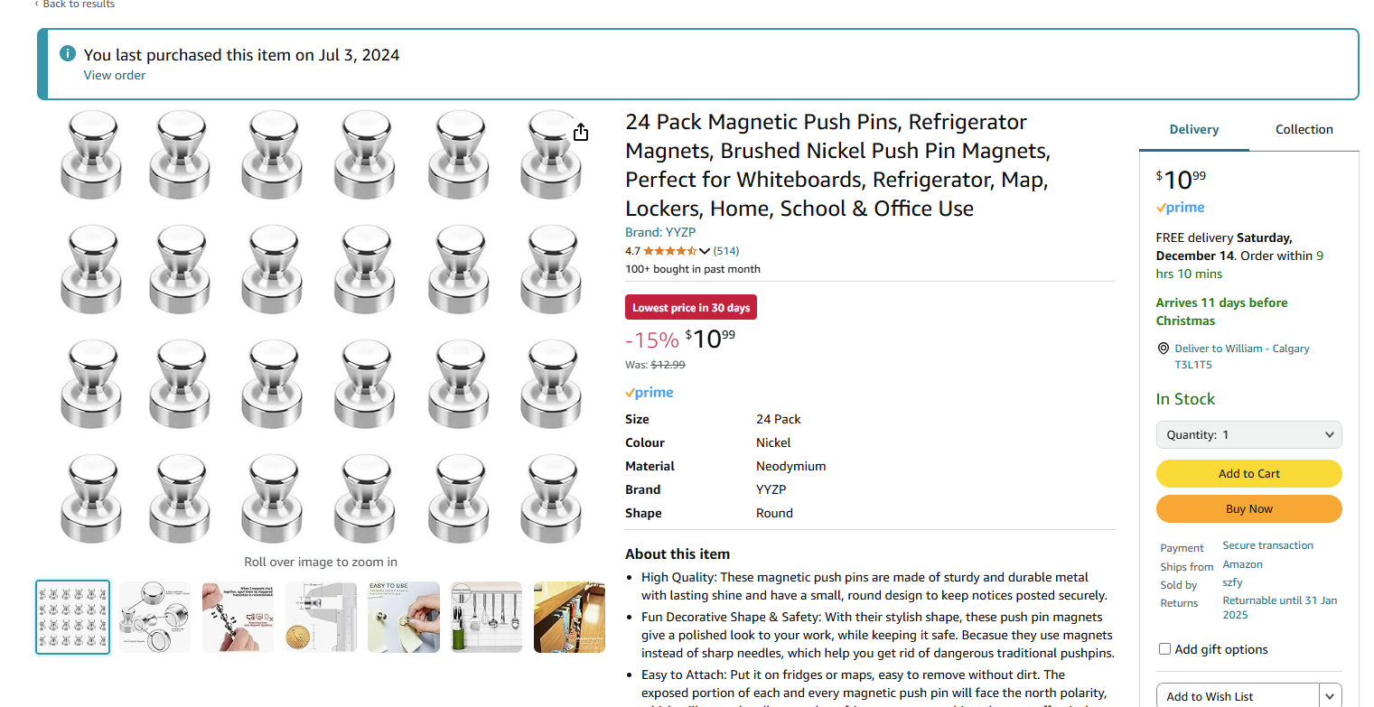

I have been using these magnets since July to hold paper and the blades on my easel in place.
