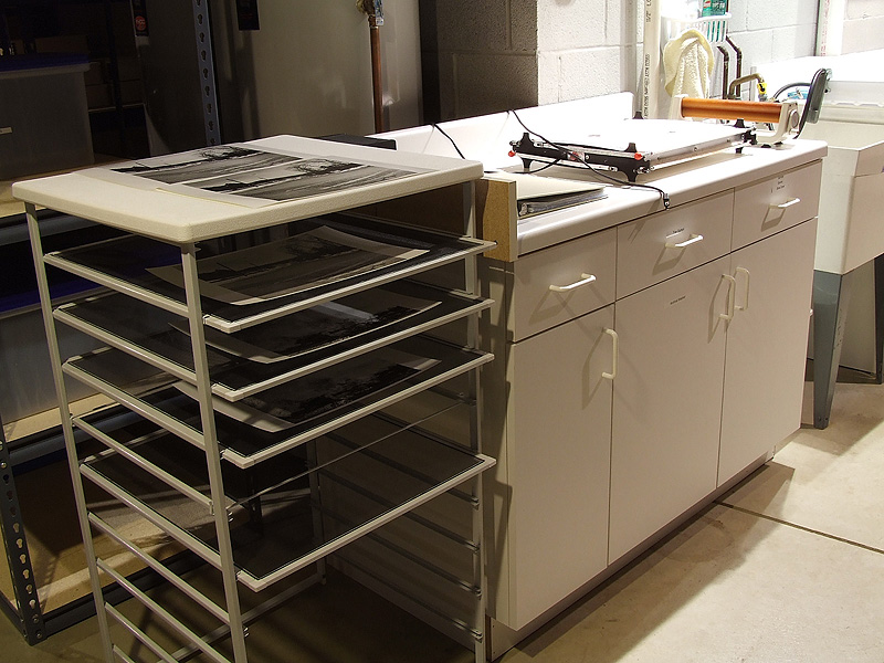

I found this at Home Depot. It was supposed to hold some trays or baskets. I made some window screens for it and have used it as my print dryer.
BTW, the heated dryer is just for the test prints.
