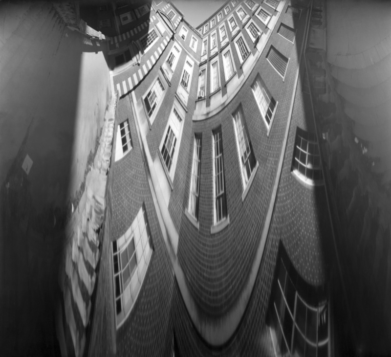

The concept of a pinhole centered in the end of a Pringles can may be extended with sheet film as shown here. The image on the negative was 8.7x7.8 inches. Since the required exposure is greater near the end of the camera distant from the pinhole than near the pinhole, the exposure was varied along the length of the Pringles can by sliding a tube up the can. Exposure was from 10 to 200 seconds on Kodak Tri-X film. A tripod socket fixed to the far end of the camera provided the flexibility needed for capturing some images. The camera was pointed at the sky a little bit above the image area. The dark areas on each side of the picture are shadows of buildings on one building and on the sidewalk the tripod was standing on.

That's a great shot Jim! I can see that architectural subjects show off the features of this kind of camera more than subjects in nature. Looking forward to trying something similar. I imagine, for example, the inside of a church would be quite something.
