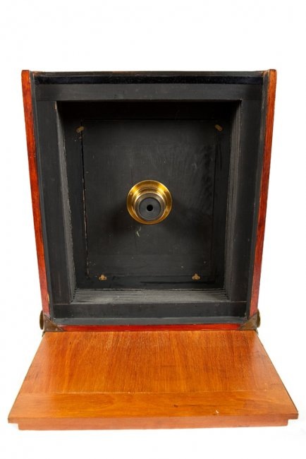

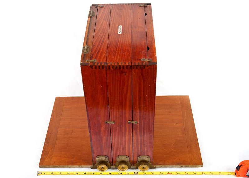

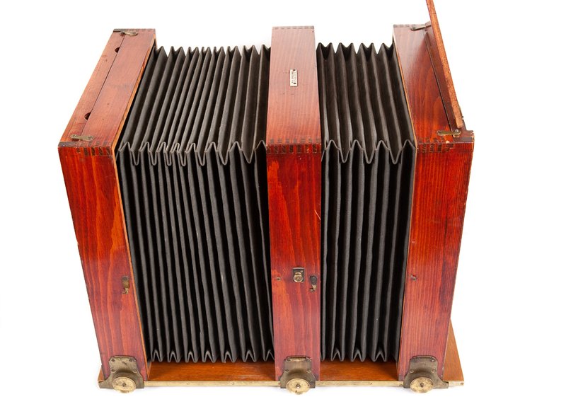

Hello,
I have an old (copy?) camera 10x12 that is in great condition but did not come with the correct bed/rail/focus system. The board the camera is currently on is very heavy, too short for this camera, and the sections won't lock in. My question is, does anybody have any good ideas on how I can build a bed/rail/focus system that will be effective, not too heavy, won't break the bank, and won't look horribly out of place on this camera? Thank you in advance!

hi
i can't speak for a rail bed system but i can suggest you look for a semi centennial stand if you want it as a indoor/studio portrait or still life %c camera.
scstands have a cantilevered/ spring system ( and/or sometimes a crank ) to raise and lower the camera on the stand and the camera sits on a long bed that sometimes extends
with the camera. there are elaborate ones and less elaborate ones and often times they are found on craig's list for free .. and well worth the trip to pick up.
other than that looks like a very nice camera, good luck finding a way to modify it if that is what you have your heart set on doing.

Thank you! I will keep an eye out for a stand. I really don't want to modify the camera at all if I can help it. I just want to be able to use the long bellows draw that it has.

Dunscombe nor Braham show up in A Lens Collectors Vade Mecum, a primarily British publication that covers lens manufacturers and their lens that were available in the UK for pictorial photography.
I wonder if this was a clinical camera of some type. Early U.S. cameras have a 3/4 to 1 inch square frame with a cross bar every 6 to 8 inches, groves in the sides that the brass guides fit into. Brass gear tracks were embedded into the top of the bed with a pinion shaft on one or both standards. Common examples are Kodak #2 (D) and Ansco View Cameras.
