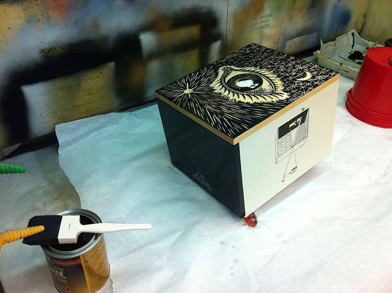

The project is coming along. I await a proper tripod socket from Skink and a 40mm drill bit and it will be ready to assemble. It is being constructed for an assignment in a printmaking class which requires it to be 3-D. Both the side boards are painted white and have screen printed copies of old drawings about how cameras/camera obscuras work. The top and bottom are black and the top has screen printed technical information on the camera. The front is a wood block carving depicting an eye and representations of day and night. A skink pinhole will be placed in the pupil. The front board has been inked and prints made from the wood cut, so it will be black (from the ink) and white/maple in the parts cut away. I'll post pictures when it is complete. Bill Barber
