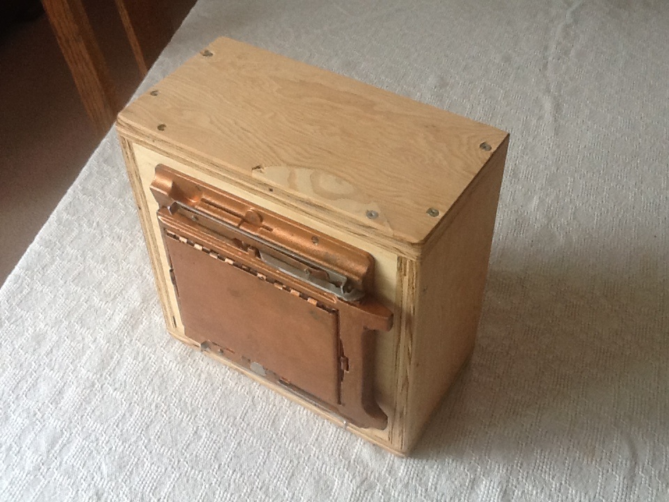

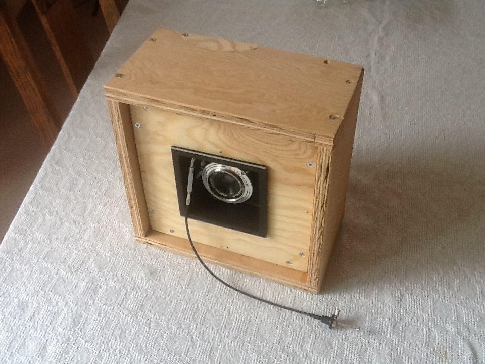

I'm in the process of building one too. I went with the sliding boxes construction for simplicity and ruggedness. I do have a 4x5 graflok back, and a 90mm lens in a recessed lens board.
