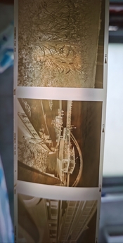

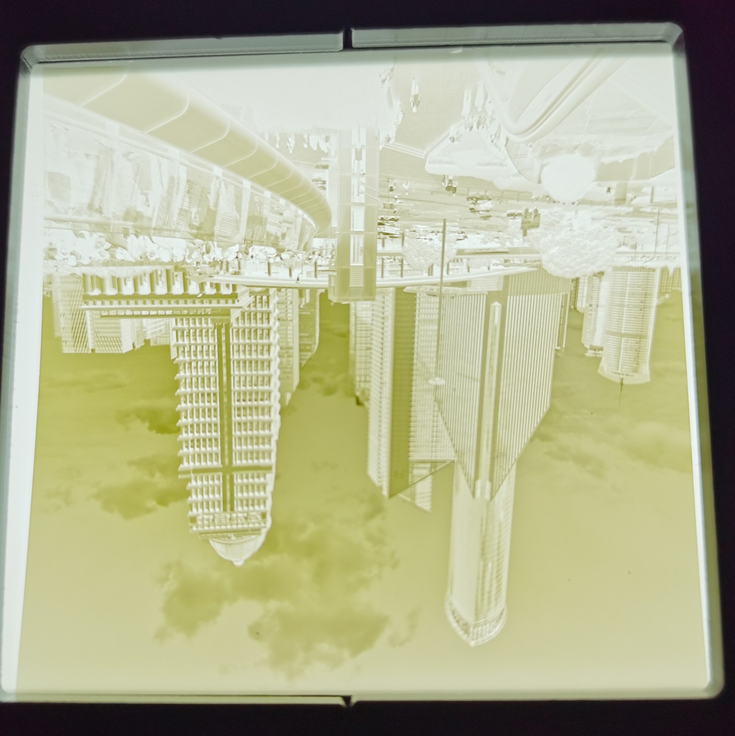

Scans and the negative is posted below.
Kentmere 400-Lomo LCA 120-PMK 2bath-7 by Kelvin Zhou, 於 Flickr
Kentmere 400-Lomo LCA 120-PMK 2bath-1 by Kelvin Zhou, 於 Flickr
Kentmere 400-Lomo LCA 120-PMK 2bath-8 by Kelvin Zhou, 於 Flickr
