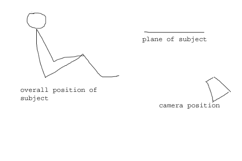

I am using an 8x10 camera with a 14 inch lens and I am having real problems with the shape of the subject and the relative proportions of different parts of the body. Normally, I can accept a little bit of distortion with regard to perspective, but with people, the distortion is obvious and just not right. I have two basic questions.
1) When photographing a standing subject, what should the height of the camera be in relation to the subject?
2) I have attached a crude drawing of a set up I tried recently which just did not work. My subject was seated on the top step of a porch with the camera at about the same height as the subject (left side of drawing). On the right hand side of the drawing I have shown the plane of the subject relative to the camera, from above. As you can see, the camera was at an angle to the subject and this resulted in a lot of distortion. On the glass, the feet were HUGE in comparison to the head. I fiddled with the front and back movements, but just couldn't get it to work. Would the correct adjustment have been to put both the front and back standards parallel to the subject?
Does anyone know of any good sources which deal the movements involved in photographing subjects full length?

In this case rear swing would have been used to correct the perspective, with the front to compensate focus. Perspective is controlled at the back by altering the relationship of the film plane to the image projected on it. If you move the part of the ground glass with the feet away, they will get smaller. The best thing to do is set up a box and play.
In general in regard to "standard" portraiture, the camera lens should be at eye level. Just below for a more dominating pose, just above for more submissive. Of course rules are made to be broken.

It would be helpful, if you could post a scan of the photo.
That said, generally one uses rear tilt and swing to correct distortion and front tilt and swing to control the plane of focus, so if the subject's feet's too big, as Fats Waller was known to have said, one option would be to use rear tilt and maybe swing depending on the subject's orientation to the film plane to correct the proportions of the feet to the head, then apply front tilt/swing to get things in focus.
It could also be that the camera is too low. You could try for a higher camera position and then use front fall/rear rise to recompose.
Sometimes you just need to move the camera or pose the subject differently.

Jason, does the eye level rule apply to a full length subject, standing?
David, I would post the photo but as Fats said, her feets was too big, so I didn't shoot it. I didn't want to waste a sheet of 8x10 and more importantly, I didn't want to embarrass her.
I have some experience with using rear movements to correct distortion but this one was difficult. People are a different ball game, aren't they? If one part of a building isn't quite right, it can just look ... dramatic. But when her feets too big... that's no good.
Tomorrow, I am going to set up the camera and try the same thing, but this time I will put objects of the same size along the same plane and practise on them rather than on a human subject who had every right to get annoyed and impatient with all my screwing around.

I would think you would need to be farther from your subject. So, if you are filling the frame, a 14" lens is way too short.

I find portrait photography to over lap with architecture photography. I think one key is to keep the back of the camera vertical for a natural look.
1) Our eyes see a building as having parallel sides (assuming it's not a Frank Gerry creation). But, we all know that if you take a fixed back camera and point it up at a skyscraper, the lines of the building will converge on the film. Our brain compensates to make the lines look parallel, the camera does not. I think the same thing happens with portraits, especially full length portraits. Our brains tell us that the subject is standing straight even when looking down from eye level, which in my case is about 5' 6" high (I'm 6' 2" tall). If I put the camera at my eye level (or the model's eye level if the model is shorter) and angle the camera down, the human form gets distorted on the film--a distortion our brains override in every day life. Consequently, as a general "rule", I try to shoot with a vertical back.
2) For full length portraits, fashion work and nudes, I like to center the camera on the model's belly button. This is just slightly above the mid point of the body (and it follows the golden mean very nicely). I think it gives a natural look to the body without giving too much emphasis to the legs. I have the model lengthen her neck and tilt her head down to look at the top of the lens to avoid the double chin and up the nose shot. I tend to do the same for closer portraits--figure out what I want in the frame and put the camera position just slightly above center.
3) Remember that things closer to the camera will be exaggerated on the film. I think this is part of your problem with the setting shown in the drawing. The feet are closer to the camera than the model's body and head, and therefore exaggerated. When drawing the model, the artist can use foreshortening--not really possible with a camera. I'd change the model's pose.
Here is and interesting experiment for you to try: Photograph a mannequin or a model. Start at eye level with the camera tilted down. Take another at eye level with the camera back parallel to the standing model (use front fall to get all the model on the film). Take several more exposures moving the camera lower, until it is below waist level. Look at the final prints and decide on the most natural looking. I have done this (back when 4x5 polaroid was around), and I decided I like the look from belly button height the best. Your milage may vary.
