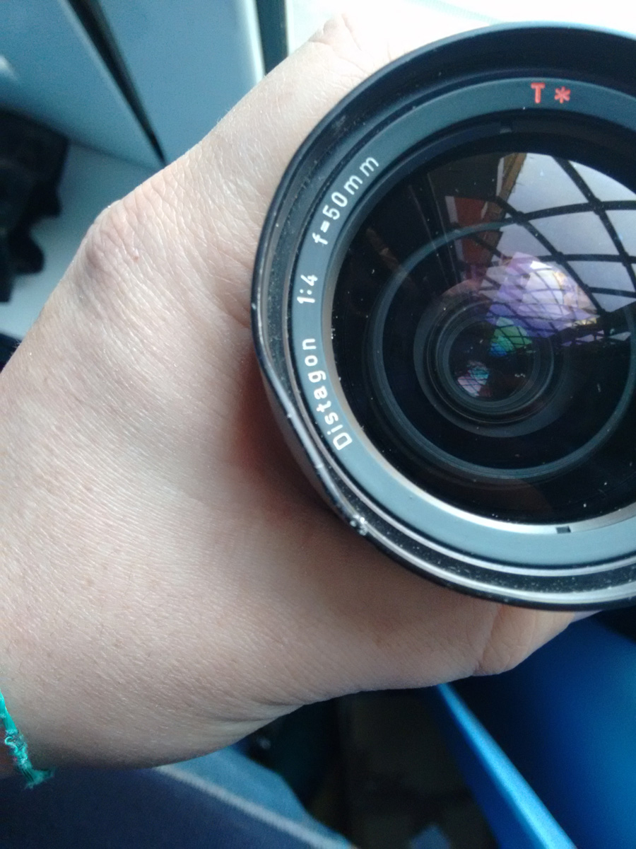

Few months ago I received as a gift a 50mm Distagon T* but it was really in tremendous conditions, it had fungus in the rear lenses group, times under 1/4 second were stuck, the truncated cone shaped front shell was loose and had two dents, time-aperture selection ring was screeching and the focusing ring was completely lacking of lubrication. In short it was destined to be thrown in the garbage.

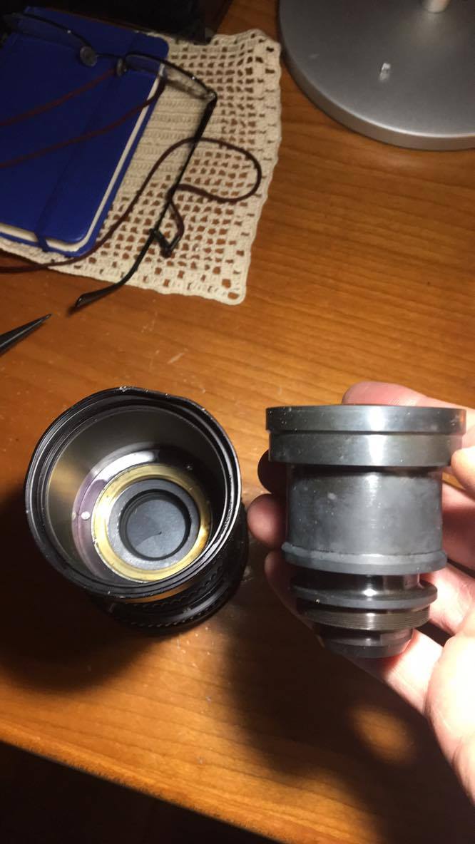

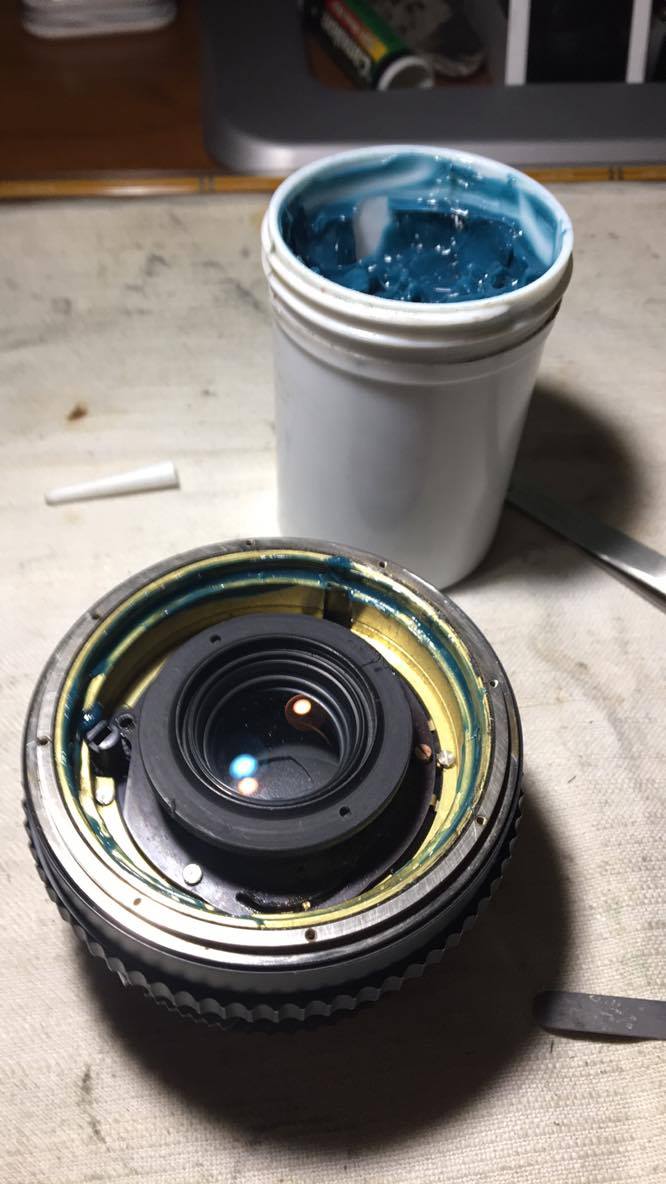

A dear friend of mine, Sandro, decided to put his hands on it and he documented the whole process.

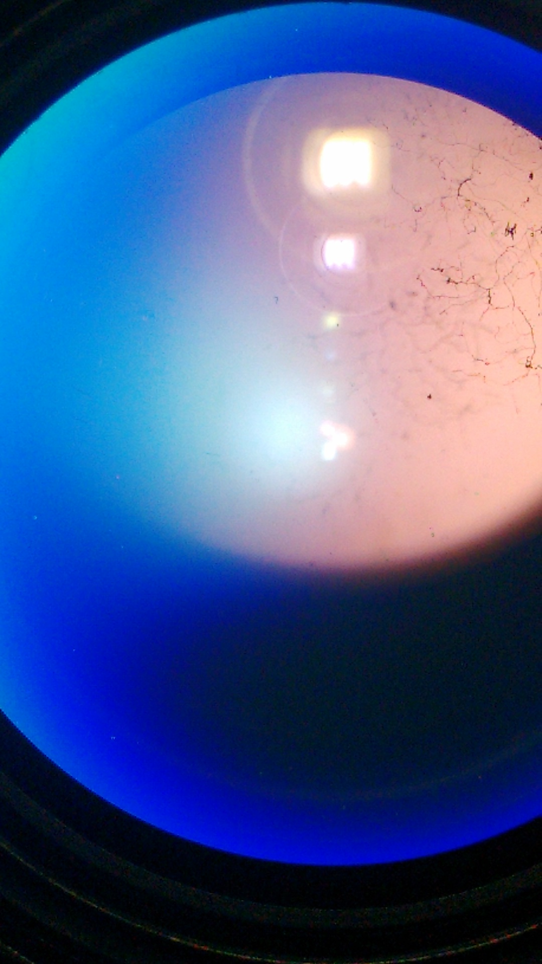

Here you can see dents and fungus
16732045_492612891126161_519772587_o(1).jpg 16734845_492568101130640_1623630891_o.jpg 16735571_492653291122121_1151654830_o.jpg
Pay attention to the solid construction of the C lenses, all metal and glass.
