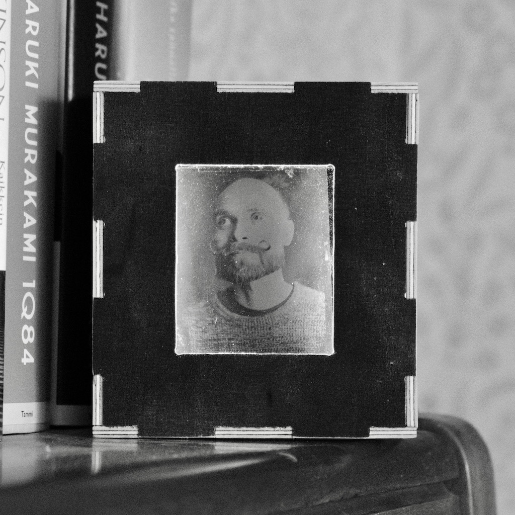

Is anyone using a dry plate proper as the final piece of "art"? If so, I am very much interested in how you are choosing to display it. Another question - do dry plate "positives" exist (on glass, I understand there are tintypes, etc.). If not, is there a way to simulate, via lighting or backing paper, the "reversal" effect so that you can use the dry plate as the final piece (as most people would expect to see it)?

You could treat the negative like an ambrotype and mount it over a black background.
https://en.wikipedia.org/wiki/Ambrotype
But isn't the ambrotype itself a positive? I am just having difficulty imagining a negative image (in which the skies are dark, for instance) against a black background. Am I understanding what you are proposing correctly?
bdial
Jan 2, 2005
7,443
North East U.S.
It's a negative, but looks like a positive because of the black backing. The light reflects off the dark areas emulsion, so they appear light in comparison to the (clear) shadow areas that are filled by the dark background.
You can mimic the affect by looking at the emulsion side of a negative so that you have light reflecting off the exposed emulsion area with something dark behind the neg.
