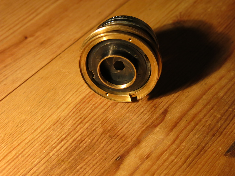

I'm trying to clean a beat up Voigtländer Vito B. It's the one with the EV scale (, so really, things may be a bit too complicated for a beginner like me..)
Still:

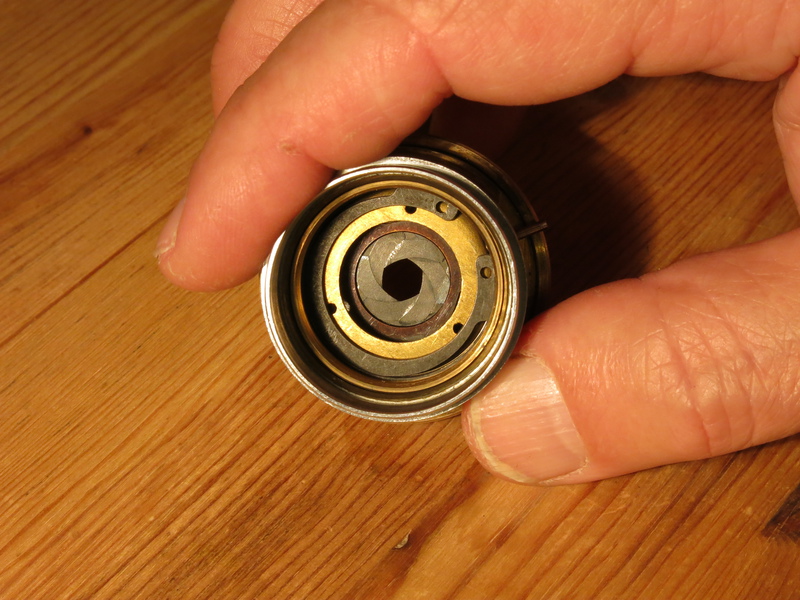

I have tried to flush the aperture blades without dismantling further the pictured part. But the aperture won't move smoothly after the solvent evaporates. And the blades don't look clean. So I think I have to dismantle this part totally to be able to clean each blade separately.

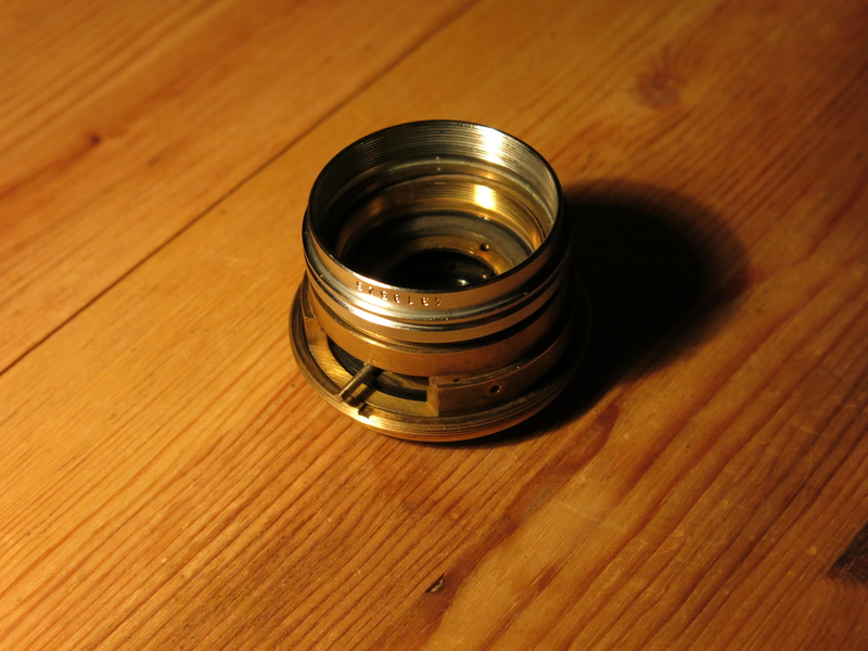

I can't figure out how to get to them. Can't get further than the stage in these pictures.
Anybody here have experience with this camera?

There appears to be a snap ring in pic #3 which when removed should allow further dismantling.

I thought so too and took it out, but the pin that points into my hand in pic #3 and that you see in pic #1, sits on the brass ring under that snap ring, so the brass ring won't come out. Unless that pin can be screwd out from the brass ring. Don't look like that.. think I risk damaging the pin if I try.

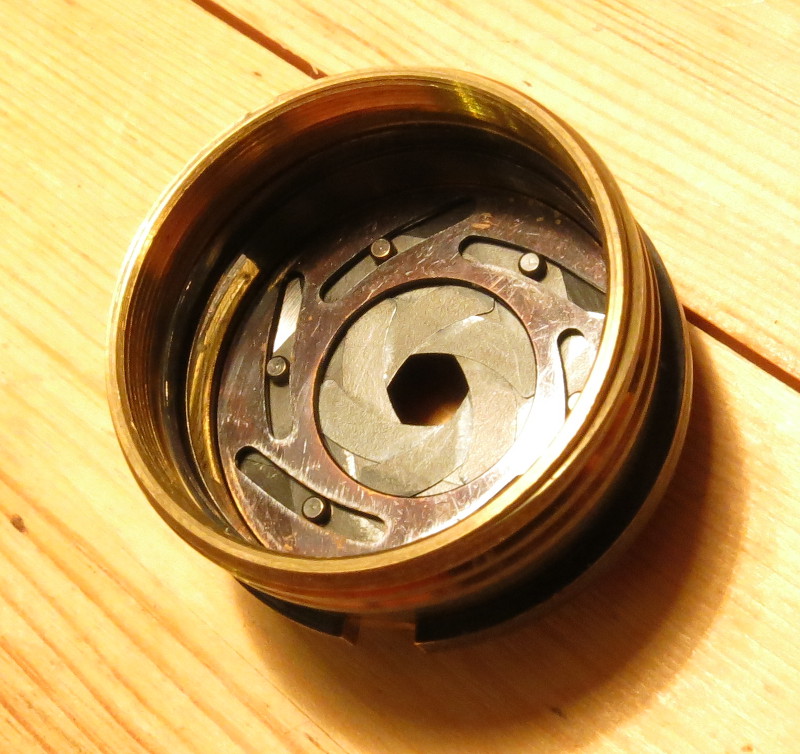

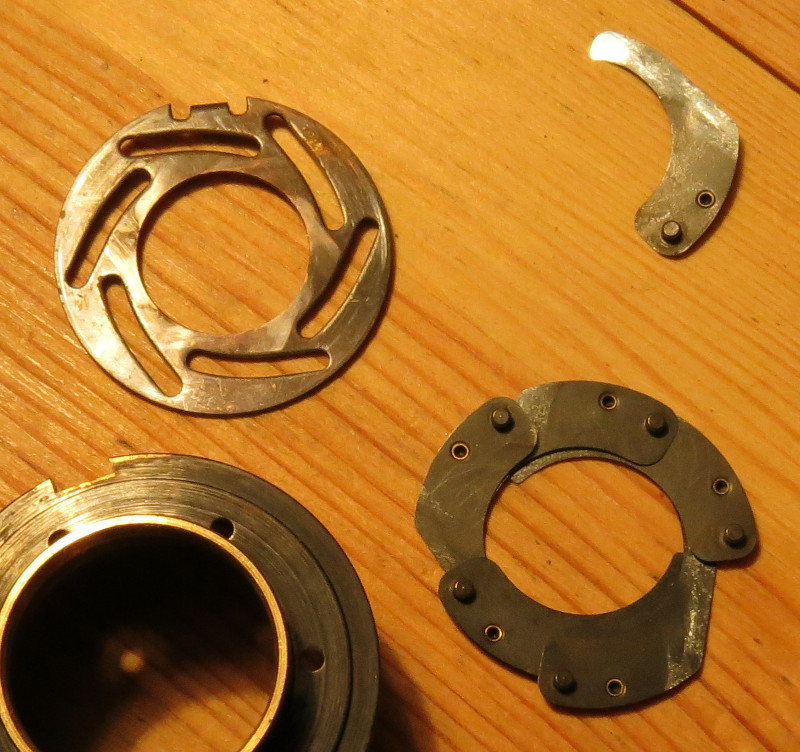

choiliefan was right, once I got that pin screwed out, and took out the snap ring, I could dismantle furter and get to cleaning the blades. These blades were easy to put back. I think, because they are not hinged in each end, but the second hinge is close to the first.
Aperture now moves smoothly!
