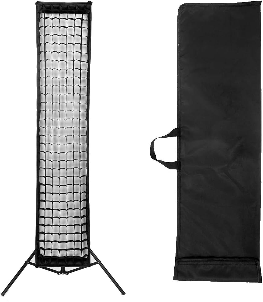

Like this below? What does the honeycomb do? I had not seen that before.
The honeycomb for both flash head and bowl will have the lighting behind the tubes, with a cutout in the bowl for mounting the flash and a honeycomb grid as a bowl 'covering', so light will pass through the tubes of both screens.
You dit not get my point. To be useful in the intended way, the tubes must be lighted lenghtwise. This is not possible with the oblique rays leaving trough the window of the the flash. Instead they must be lighted by the rear of the bowl. And this again must be lighted by the flash-tube, which again is not possible due to the reflector housing.
Honeycombs are a long time means to yield rather parallel light. Both the length as the diameter of the combs/tubes affect the parallelity of the light. Strange enough the OP seems only interested in the lenght.
The superior stage would be a huge fresnel lens.
So, the idea being it is hard to put a big barn-door on a flat diffusion screen to prevent side-spill light?
No, you are comparing two different things.
-) Barn doors only can only control the boundaries of light ( light cone).
-) Honeycombs can control the character so to say of the light within the output too.

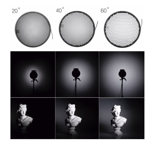

Grids focus the output of the strobe, and come in different sizes (usually referenced in degrees), depending on how narrow or broad you want the output to be. Softbox grids do the same thing but less so since the light is already diffused.
Thanks for the example. Looks like a softer way to concentrate the beam, vs the moving lens on a zoom-shoe mount unit.
What you show can basically be achieved with barn-doors, or (to yield a round shape) with snoots.
I do not reject that grids can and are used that way. But the benefit of a grid is that it yields more or less directed light. At leasr if te combs are small or long enough. Then they are kind of counterpart to a softbox.
Barndoors can be heavy and impractical with large lights like soft boxes and beauty dishes. And of course, grids give more directed light.
This looks to be a studio attachment to be used with a light box, for controlling a scrim light, a narrow, light source to say, for a full length body shot braced by darker or unlit backgrounds.
As I mention elsewhere, panels can be used, but the light will no be as controlled and directed as with this lightbox add on.
You could try to make a similar unit, by using some black closet shoe 'racks' or hangers, Velcroed or sewn, together with excess material trimmed away neatly.

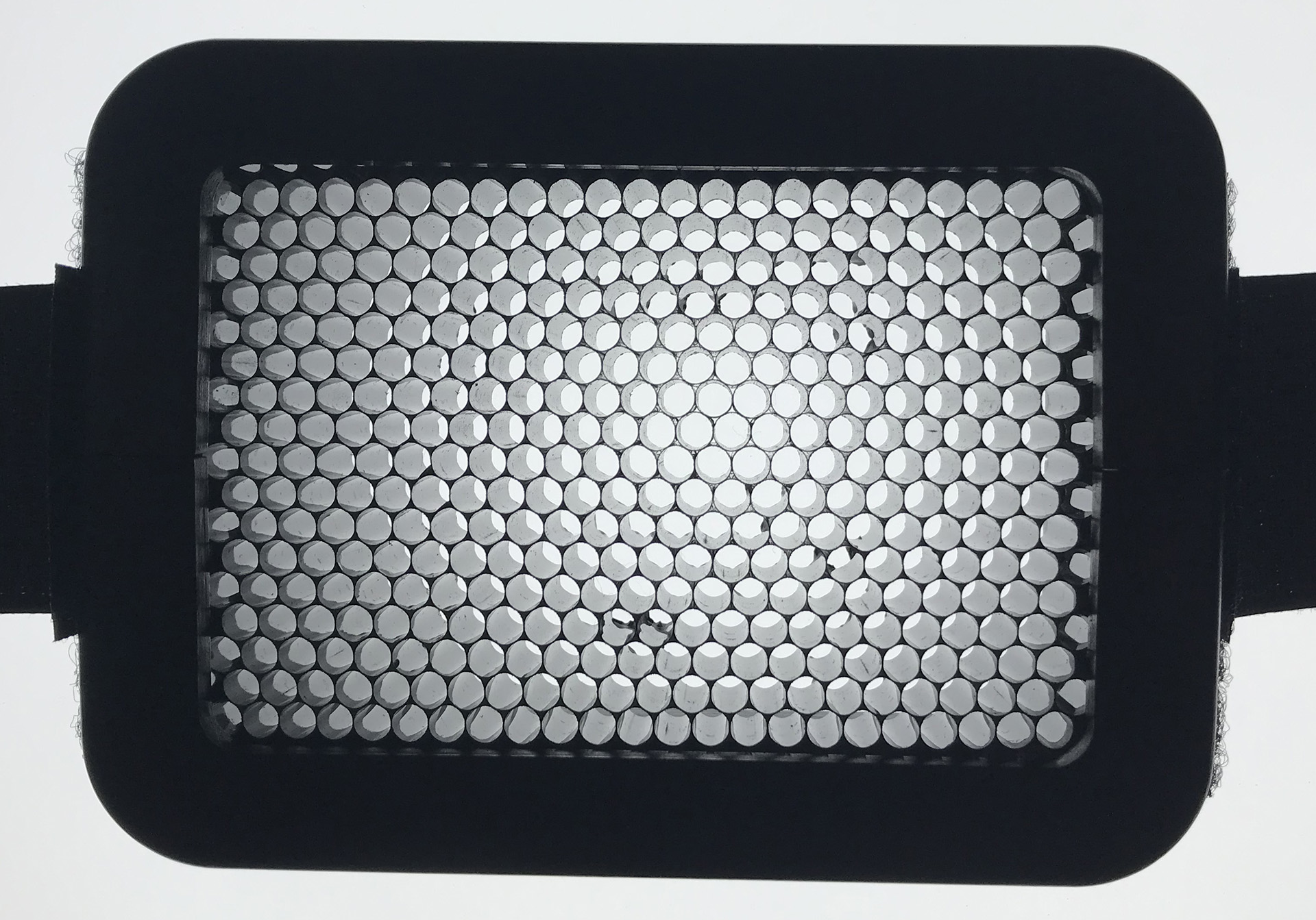

FYI, here is the one I use with a shoe-mount strobe. It attaches to a velcro strip wrapped around the business end of the strobe, The tube diameter is 4mm, the length is 15.5mm. I mostly shoot B&W, but have not noticed a color cast when shooting color.
