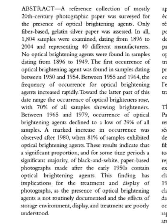

https://player.vimeo.com/video/282001700
from xrite/pantone: [color managing with OBA]
https://www.xrite.com/-/media/xrite...l_brighteners/l7-567-mfactorwhitepaper_en.pdf
and from archivist point of view [and history]
