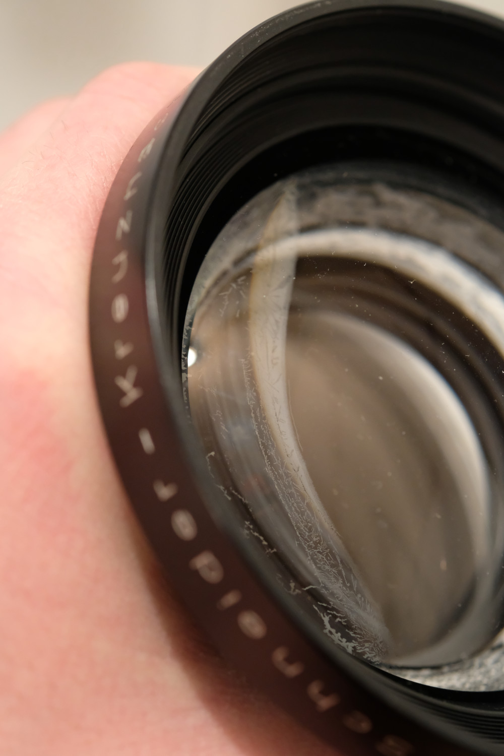

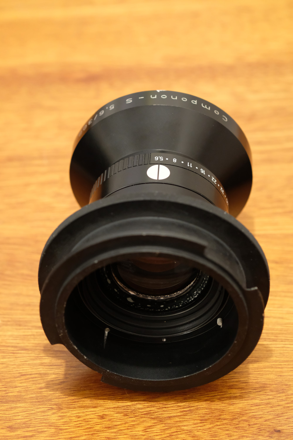

I've not used this enlarger lens for a while and for some reason it has developed a fungal problem. I've not had this with any of my other enlarger lenses, but would like to get the 300mm back up and running; although I haven't yet checked on effect of fungus on performance. Does anyone here have experience of disassembly of this lens and getting rid of the fungus?
The lens is currently in a DeVere mount and the main issue is with the front lens cell as you can see.

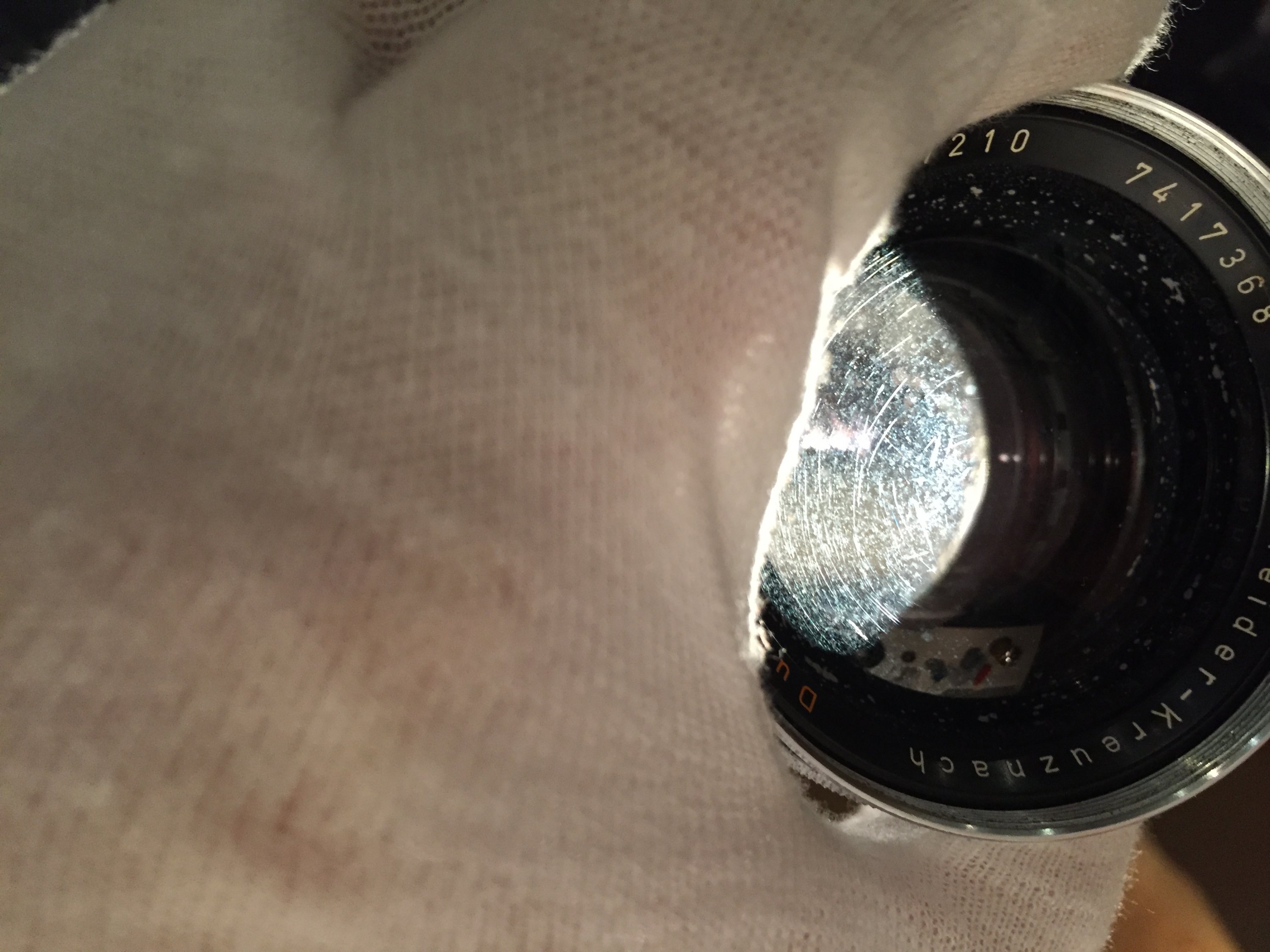

Mine is shown here after cleaning. There is some permanent damage to the coating.
The 360 came to me like that. I cleaned it abut ten years ago and again recently, but that haze does not go away.

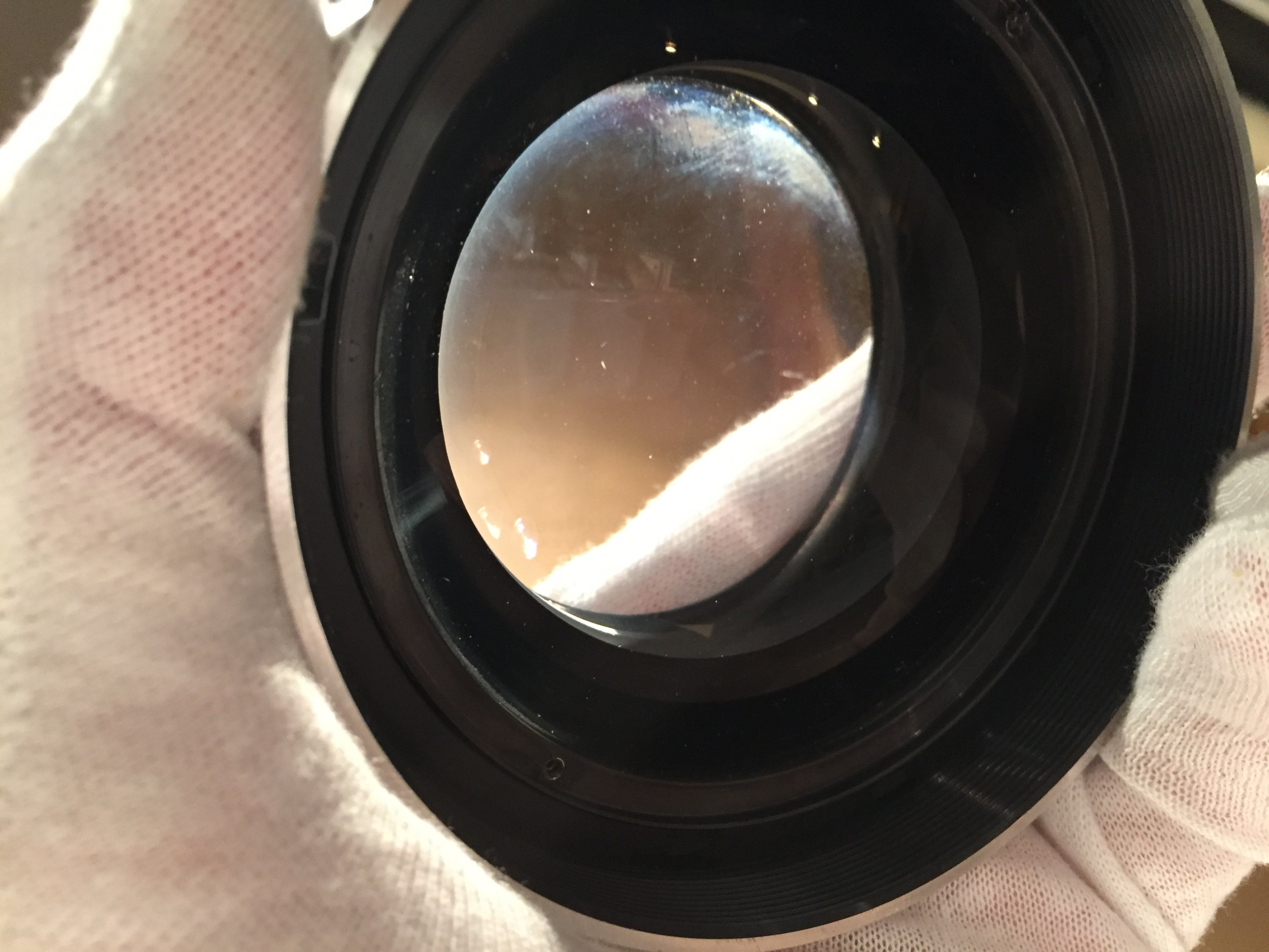

I got these two in poor condition. I used these two for many years and recently replaced them with newer versions, but I can't really say there is any difference in the prints. If you just look through these lenses (without the direct light) they appear clear.

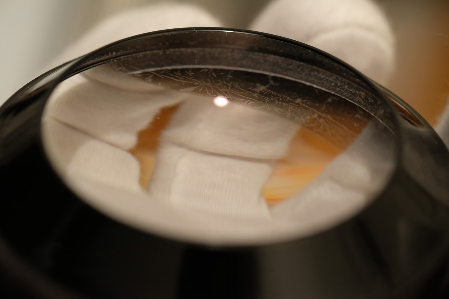

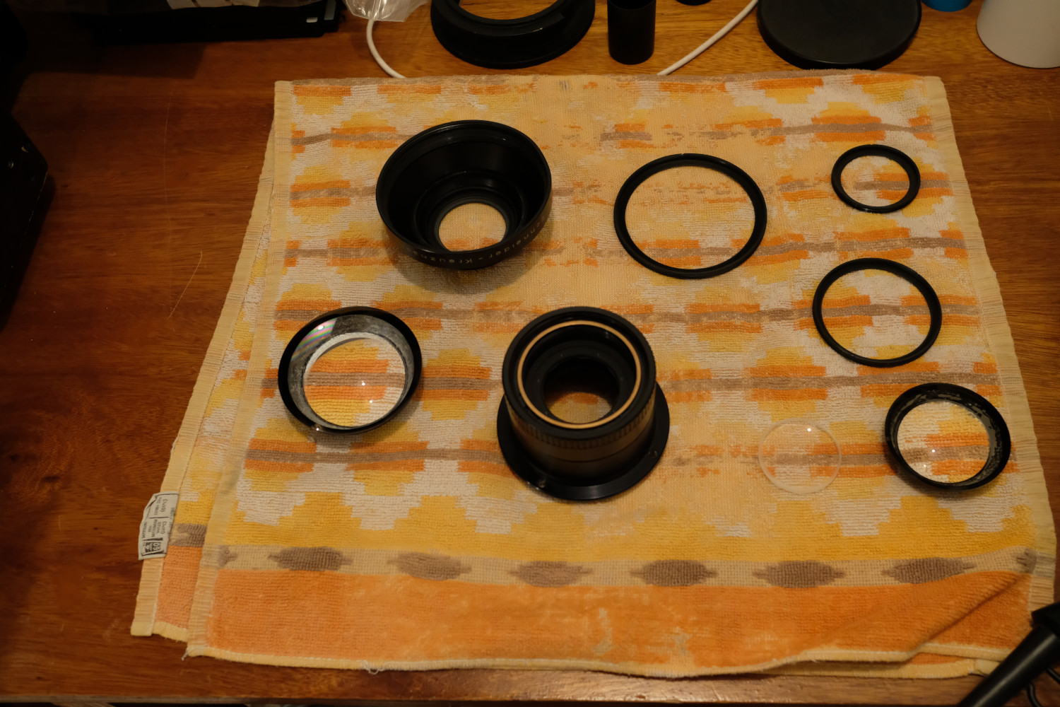

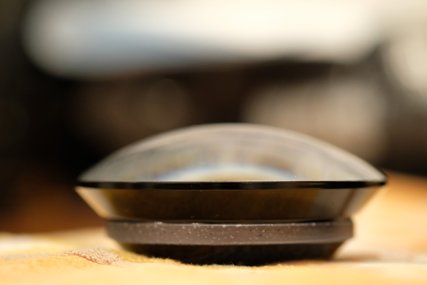

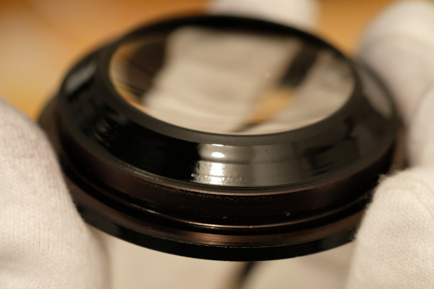

So this is the stage I've now got to. With regard to the part with the fungus, it appears to be on the underside (internal) of the frontmost element. I'm not sure what the best option is, clean up the front element "package"? see photos:
the rear lens set is of a similar design but doesn't show fungus:
Jason Lane is the expert on this. He did some nice work for me recently on my 240 chrome Symmar. Is the separation between the elements in the cemented groups? Even so Jason might be able to recement this? I would inquire if necessary
I'm in the UK so don't particularly want to send large lenses over to the other side of the Atlantic ocean for repair. Perhaps Jason Lane would be willing to offer some brief advice though?
Update: Earlier this evening I cleaned up the lens elements in warm water with a standard detergent, remarkably this seems to have reduced the appearance of the fungus significantly, although there is still some residue; I'll rebuild the lens tomorrow.

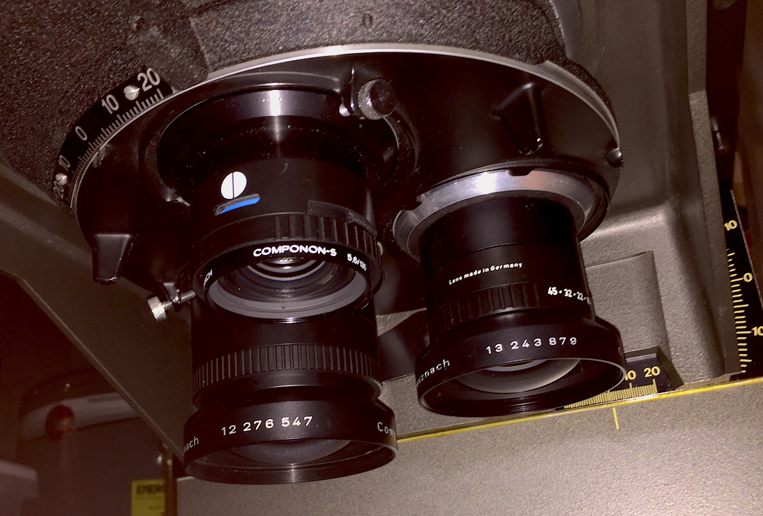

In my case, after cleaning, the lenses were not much better to look at. So, one week after losing sleep over it I went on an epic search to replace three silver componon with three modern Componon-S in black barrels.
One thing I found is the new lenses won't fit on the extended Durst mounts of the old lenses. So getting all the new lenses mounted was also a little ordeal.
In the end my enlargements are no different.

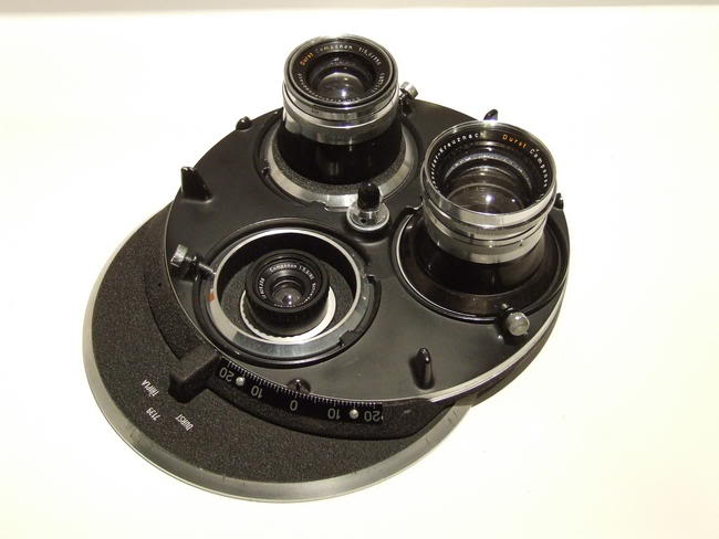

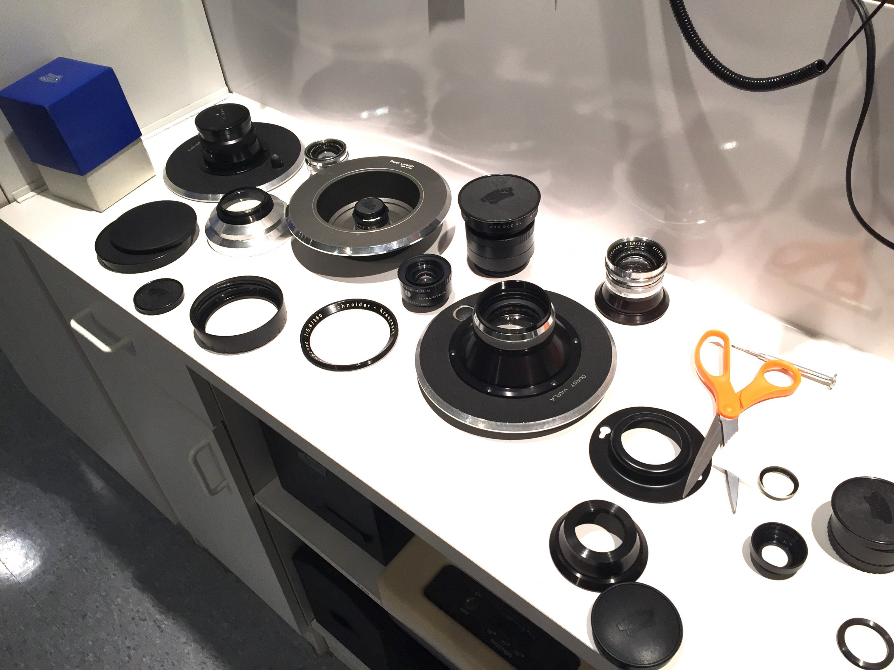

The Durst uses either single large disks (for 300mm and bigger lenses) or the "Tripla" turret for the intermediate lengths, and a special recessed disk for 80 to 50mm.

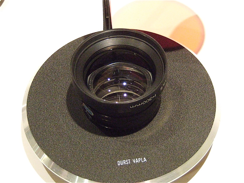

I'm very fortunate with my 300mm Rodenstock that came with my first Durst enlarger. It is like new inside and out and even still has the Rodenstock quality seal on it and I have the original receipt for it from 1988. Maybe some lenses are more resistant to fungus or haze?

I have even contemplated removing the 300 and storing it outside the darkroom. But when I checked it last winter, in my 12 years of ownership it was still perfectly clear. I don't know what people did to my old silver lenses. Every silver enlarging lens I have has scratches or haze.

That does not look like fungus to me. I suspect the Balsam glue between the elements is failing. You might consider exposing only at smaller apertures to avoid the bad glue near the perimeter.

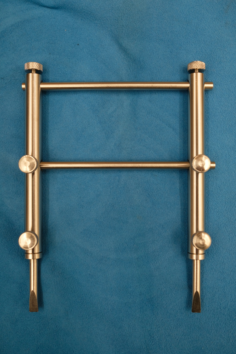

It works. I ended up using the lens spanner / wrench shown in the photos below, the whole contraption is not particularly robust relative to the forces applied but at least I now have a functional 300mm enlarger lens again. Haven't made a print yet but projection looks fine.
spanner at near maximum setting for Componon-S 300mm:

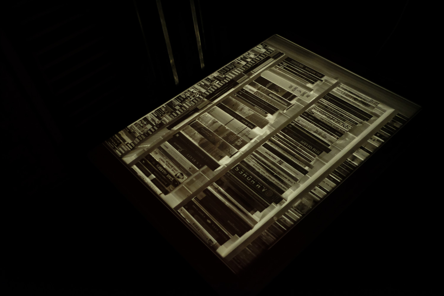

projected image from 10"x8" negative on De Vere 5108:
Looks great to me. Glad your Comp cleaned up in the dishwashing sink :smile:
