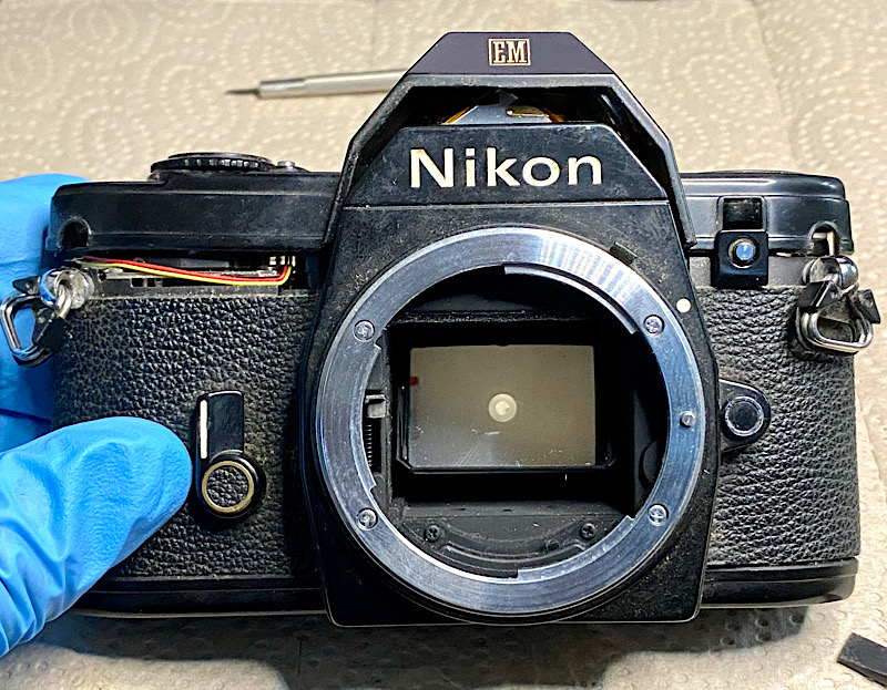

The Nikon EM for example is considered a simple SLR. Both in terms of operation and structure.
The former is certainly true, its target audience appreciated and appreciates the few functions that are not meant to be overwhelming.
Easy to use, relatively simple in construction: The Nikon EM from 1979, aimed at everyone.
However
if you compare working with the EM with a photo smartphone, even the small EM is only something for specialists, if only because film has to be inserted.
Electronics in SLRs are never trivial, but at least in the EM they are still arranged quite clearly and do not block the way into the interior of the camera.
If you want to disassemble, service and reassemble the EM, the clear construction is a plus compared to SLRs with more functions.
Removing the front panel, which gives access to the shutter and mirror box mechanism, requires comparatively few steps.
But here too there are invisible traps that take time to escape. Unless you are already familiar with the camera.

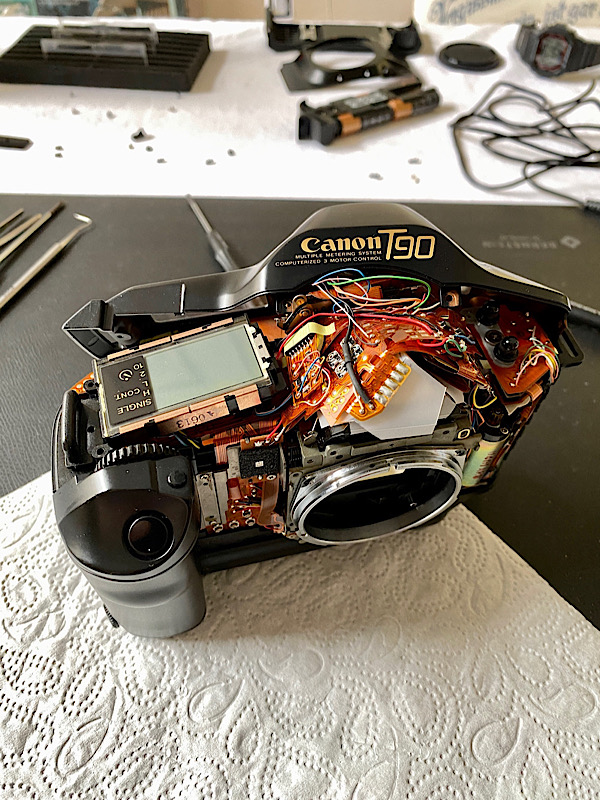

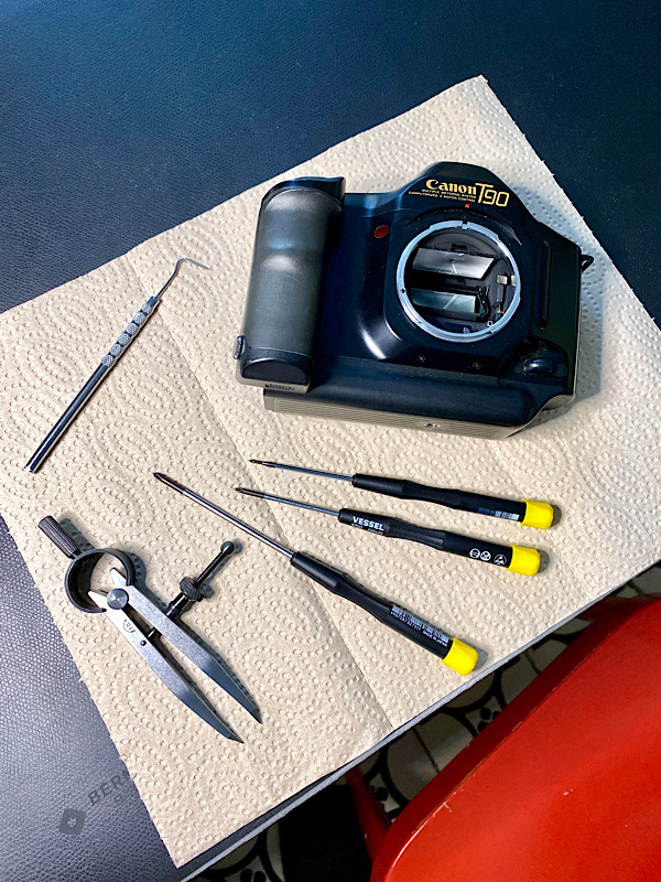

are complexity giants such as the Canon T90, which probably has the highest level of difficulty among manually focussed SLRs. In the mid-80s, an almost unbelievable symbiosis of mechanics and digitally controlled electronics was achieved here, which is unparalleled.
From the outside, you wouldn't guess that the Canon T90 is probably the most complex MF SLR of all time.
The inner workings of the T90 are accordingly tight.
To get to the shutter, for example, you have to solder through several layers of flexible circuit boards. Without instructions it's a maze and even with instructions it's a challenge in terms of organization and perseverance.
This means that repairs to the shutter or mirror box are still possible, but fail due to the effort involved.
It quickly becomes clear that taking the T90 apart and reassembling it is a challenge for the organization. Flexible circuit boards are sandwiched on top of each other, and without instructions, getting to core parts like the shutter and mirror box without accidents is a pure gamble.

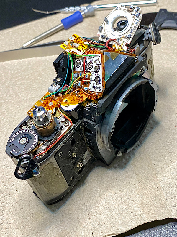

It varies wildly from camera to camera. I'm currently working on a Yashica FX-D, released in 1980. It is wonderfully designed on the inside. Great use of flex cables. Removing the mirror box takes just a few minutes and doesn't require a ton of soldering. It's a really easy camera to work on.
I've also repaired the Pentax LX, released in 1980. It's a nightmare. Wire routing is super chaotic and there's almost no use of flex cables or connectors to keep things efficient. It feels like it's from a different era compared to the FX-D.
And despite their complexity, I think in some ways, electronic cameras can be easier to work on than fully mechanical cameras. On something like a Pentax MX, there are a lot of manual adjustment points and you need specialized measurement equipment if you want to do anything with the shutter. With an electronically controlled Copal shutter, you can disassemble and clean it without messing up the curtain tensions or the shutter timing.
In general, I think electronic cameras are misunderstood and people are overly fearful of them. In many cases, they can be serviced just as well as mechanical cameras.

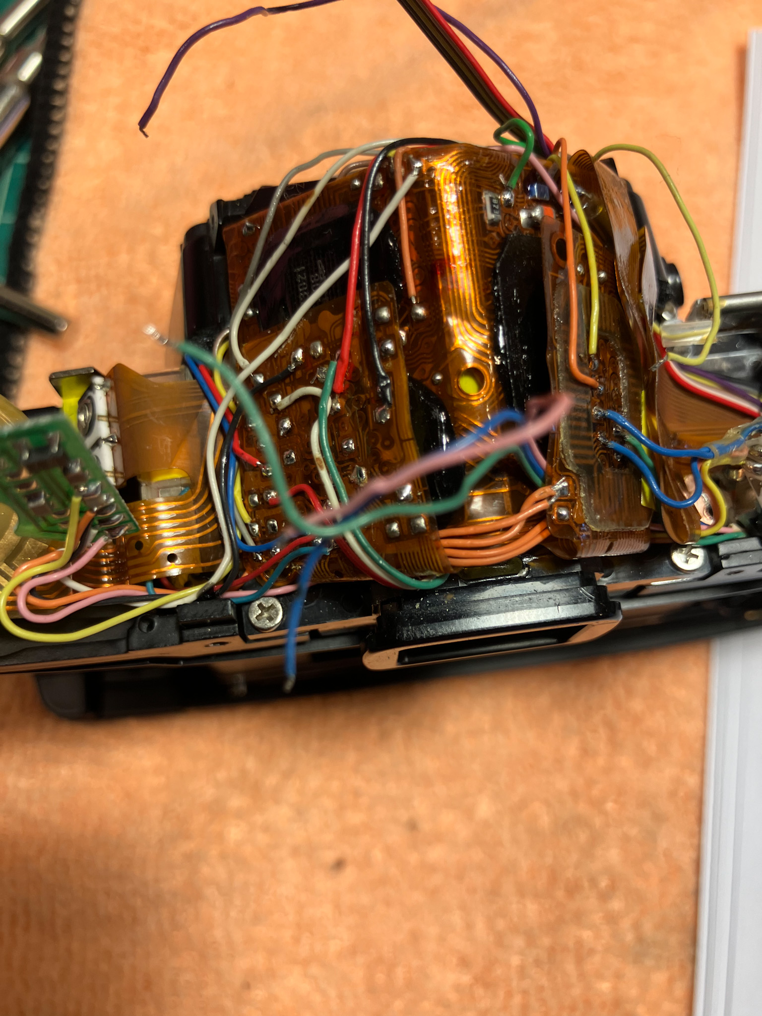

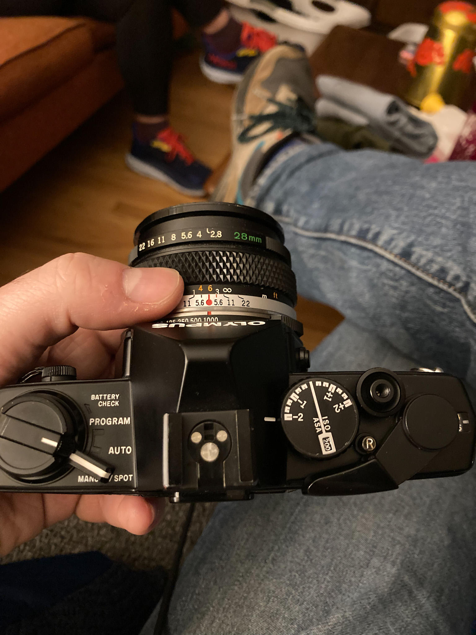

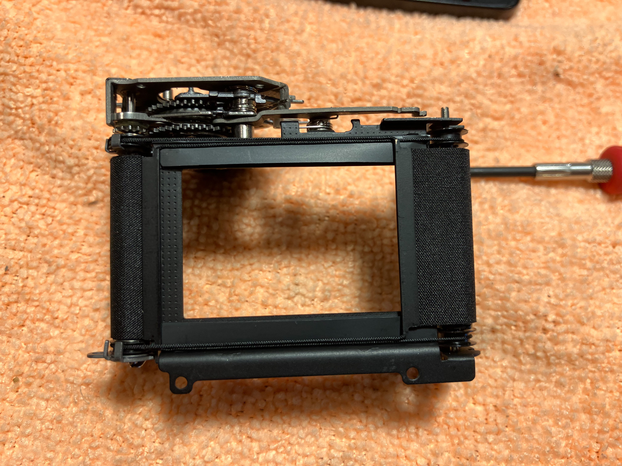

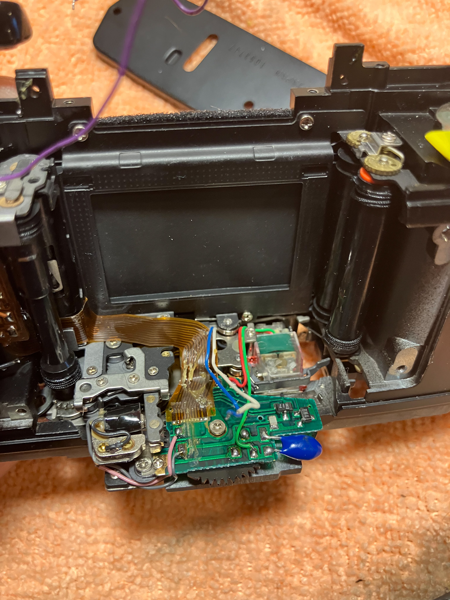

I picked up a broken Olympus OM-2s for $5 and had a go at fixing it. Luckily there are actually fabulous repair documentation for the 2s with everything from unfolding the flex pcbs to extraction of the shutter. Unfortunately while I was able to solve the film travel and mirror issues there’s now a bug and the camera only shoots at top speed when in electronic operation. I’m pretty confident I know the fix, but I can’t stomach going through all that fiddly soldering a second time.
This was my first time diving into an electronically controlled camera and I actually left pretty impressed with what I could do and get at as a repair person without software. The shutter and film transport has only small differences from the OM-1, and there are instructions in the service manual to adjust most anything you could imagine from a small handful of potentiometers.
That all being said, I would not run off to do it again.
