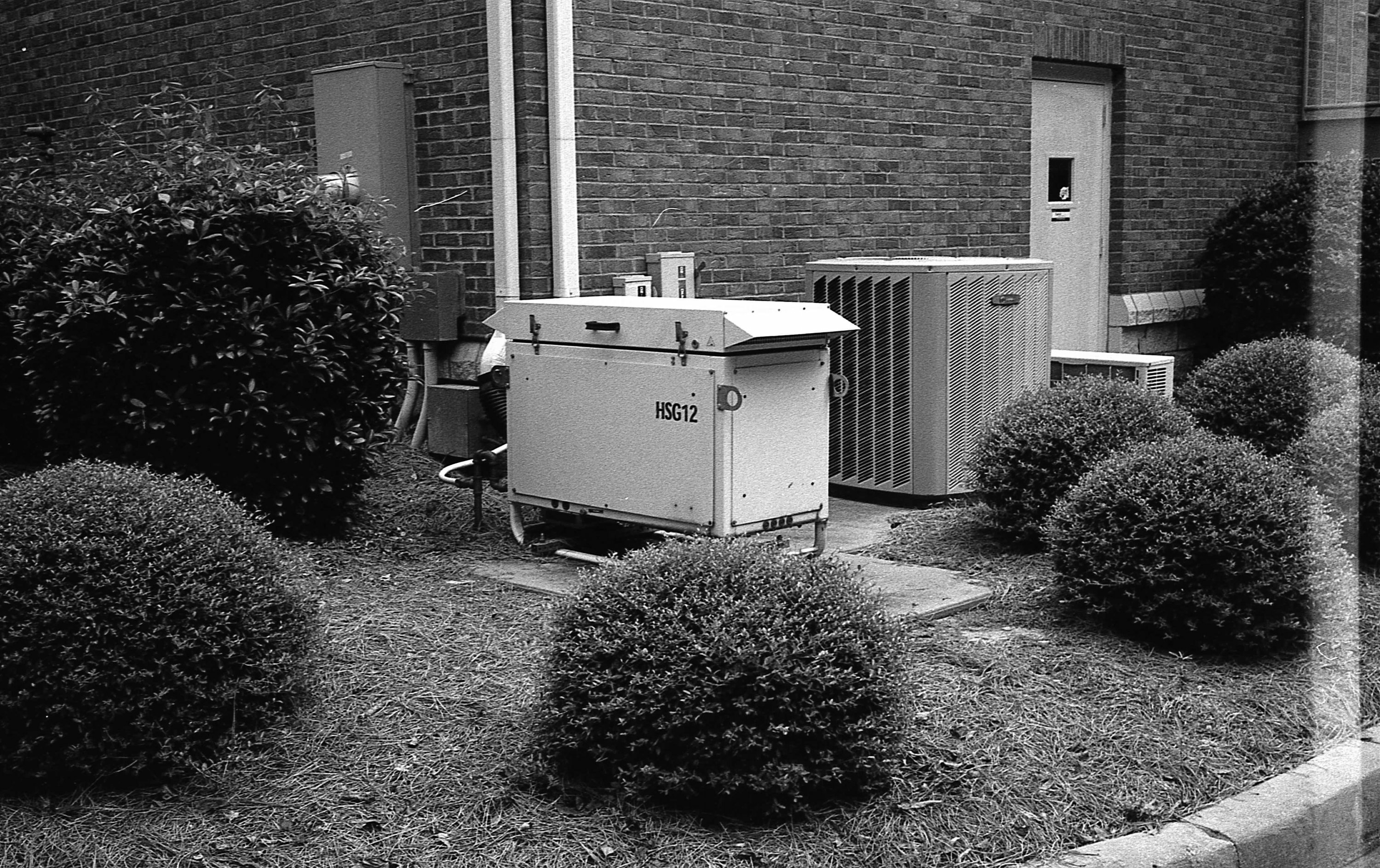

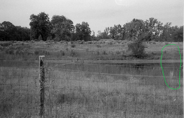

I just processed the first roll of film from my 'new' Leica M3. There is a pronounced light leak in several frames early in the roll that appears randomly, but always on the right side of the image. It faded by the end of the roll.

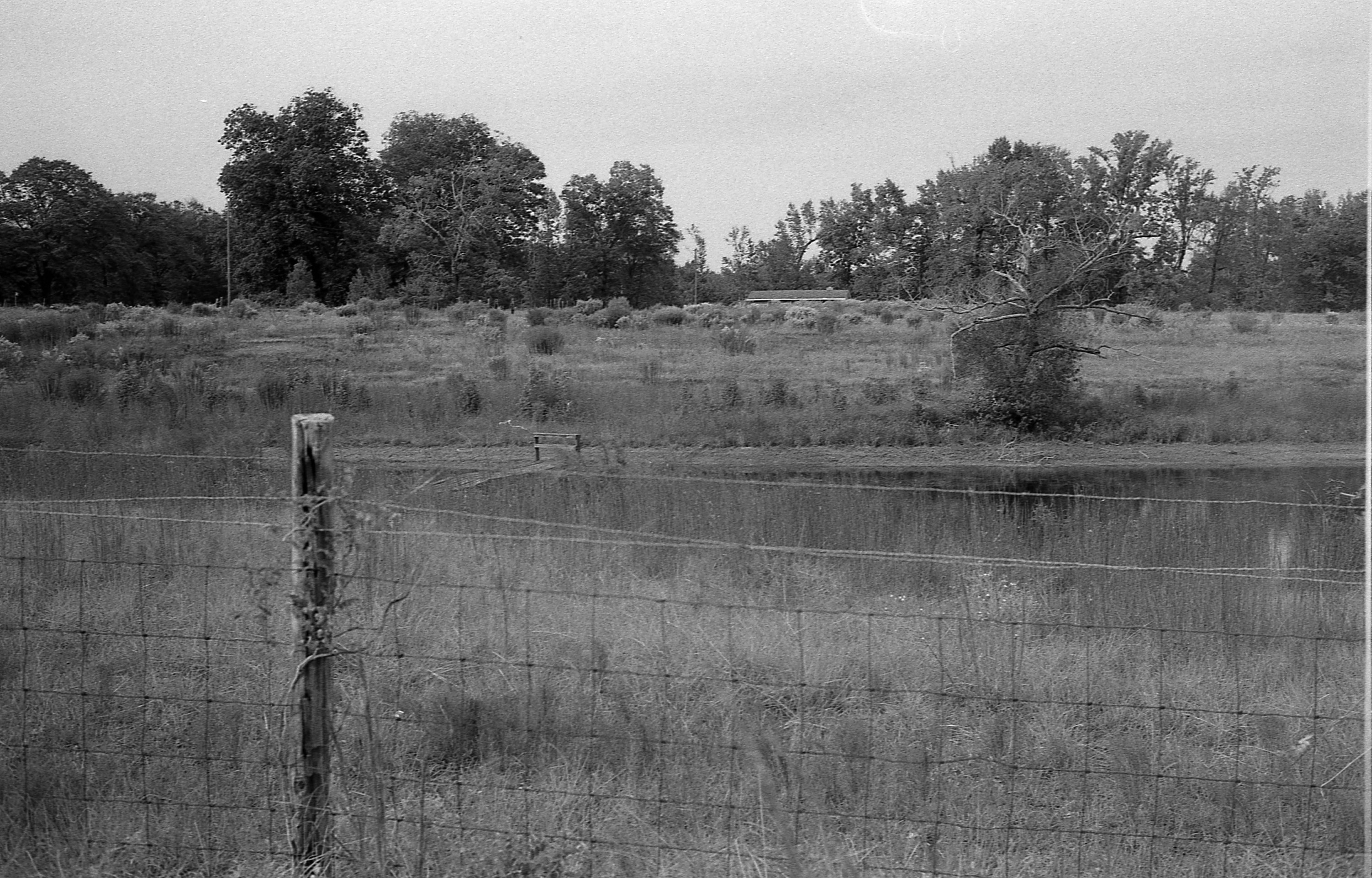

From the end of the roll:
It's present in several frames in between these two, at different shutter speeds. Did the shutter just need 'exercise'? No idea when the camera was last used.
Anyone else have experience with this?

Second curtain is dragging or hitting something, and activity either wore away the drag a bit, or moved the "something" before end of the roll.

What you could do is exercise the camera - by dry firing it - for a while and see if that then improves the situation. The obvious answer is it needs a little TLC. Or CLA..
