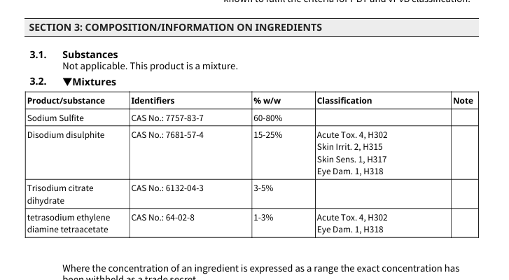

MattKing
Apr 24, 2005
53,898
Delta, BC Canada
FWIW, based on the MSDS, the Kodak HCA also includes the following components, some iof which I believe are intended to help maintain an appropriate ph level:
