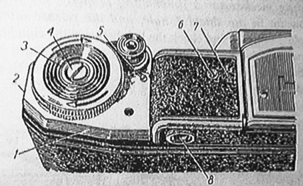

I have what looks to be a dirty / cloudy viewfinder Moskva 2.
It looks like a simple task to remove and clean.I removed two screws on
top of the finder. any tips? nothing seemed to loosen this device. Thanks Cliff

Cliff,
According to my copy of Isaak Maizenberg's "All You Need to Know About Design and Repair of Russian Cameras" (self published, NO ISDN number or LOC number), you need to;
"Dirty Rangerfinder Block: The rangefinder prism block and the protective glass on the top shield gradually become dirty which significantly worsens the visibility. Therefore, they should be cleaned regularly, every 6-12 months. To do that, after unscrewing the two screws 6 (Fig. 32) and the eyepiece 8, remove the protective shield 7. With a piece of cotton dipped in alcohol, wipe all prism block surfaces not covered with flat paint; the eyepiece 8 and the protective glass on the shield..."
