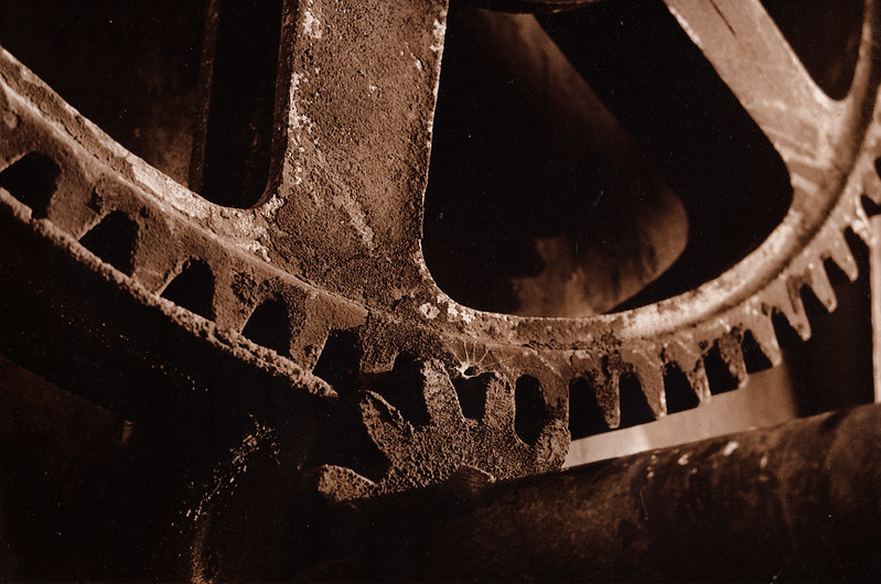

I also like the look of MGWT in brown toner. I still have stockpiles of Agfa viradon. I direct tone for 3-7 minutes. Works best for low key images, such as posted above, and I'll sometimes selenium tone first breifly to help keep my darks dark. High key images can go "pinkish".
