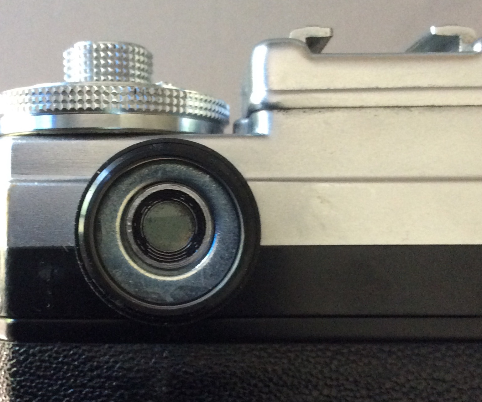

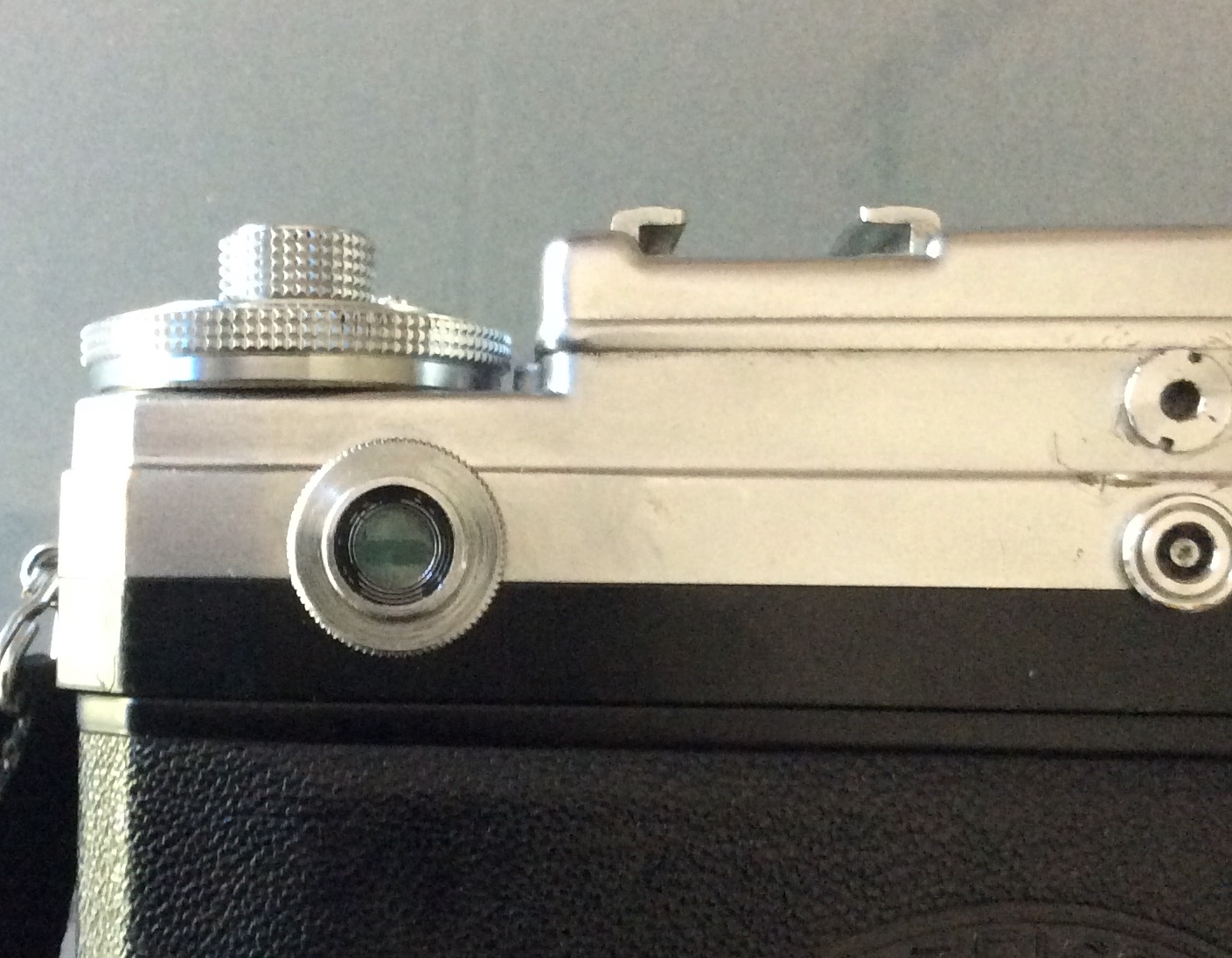

I’m using a diopter lens on most camera’s I use (olympus om-4, hasselblad), but never found anything for my Contax camera’s, which made focussing a bit difficult, it works, but takes some time.

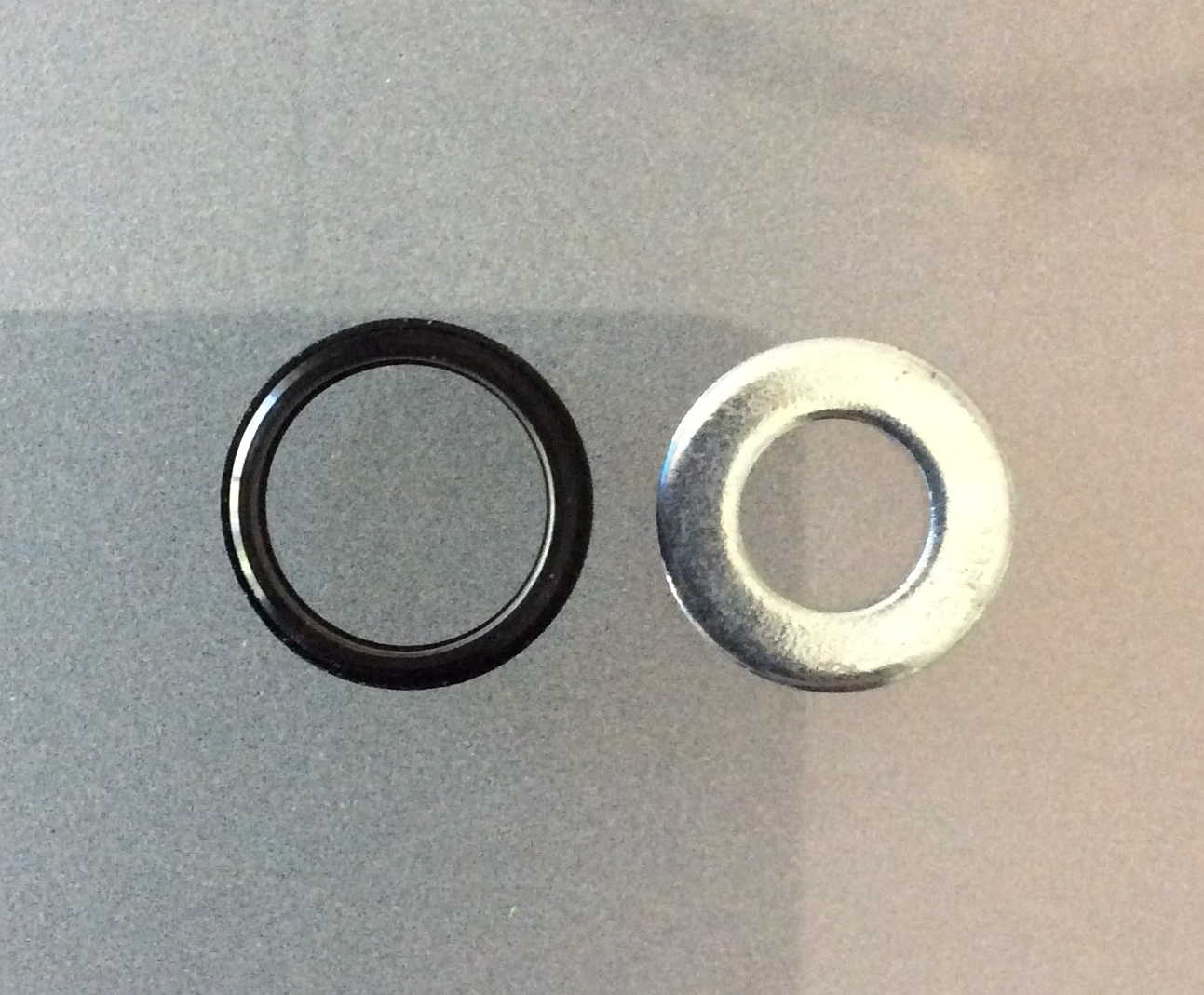

On ebay I saw cosina diopter lenses for some Bessa rangefinders. I knew they were too large, but thought there might be some solution, so I ordered one in my strength. This is the solution I found: I glued a metal ring over the finder opening and on that I glued the diopter lens. It fits perfectly and the rangefinder spot is sharp as it should be.
