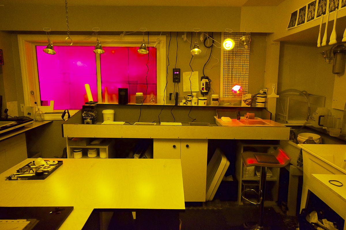

I'm wondering what people are using for 'safelight' in their alternative process dimrooms.
Just started making salt prints and have been working in a pretty dark room, to eliminate at least one variable which could effect the higher tones in a print. Also, coming from a darkroom environment, it just seems wrong to be turning room lights on while working!
Today I exposed a swatch of sensitized paper to about a Zone VIII density with UV light, then started exposing it to different lighting scenarios.
Have a 7 foot x 3 foot window (always in the shade) covered in 20x24 sheets of rubylith which passed with flying colours...20 minutes, no fog.
Have 7 small LED safelight bulbs (yellow) in bullet lamps scattered around the sink area...20 minutes, no fog.
25W incandescent bulb bouncing off the wall in the coating area...20 minutes, no fog.
25W incandescent bulb in ceiling...20 minutes, no fog.
Thomas Duplex Safelight, vanes open...20 minutes, no fog.
NOMA 60W LED cool bulb in ceiling...fogged paper in 7 minutes.
NOMA 60W LED warm bulb in ceiling...fogged paper in 7 minutes.
Fun project, especially since salt prints are a printing out process so there was no need to mix up any chemicals.
What's your dimroom safelight sauce, and for what alt process(es)?

Decided to go with all lights blazing, just to see where the limits are. If you can handle the tension, I'll give real time results.
Coated and dried silver nitrate with all LED's on, 25W incandescent bulb pointed towards ceiling in the coating area, red filter vanes down in the Thomas Duplex safelight, and the rubylith covered window.
Began fog test with lights same as above, paper in the sink area, but with vanes fully open and amber filters in the Thomas duplex.
So far up to 15 minutes, no fog.
Getting 20 minutes now, so next update about 10 minutes after the hour.
It just doesn't get any more exciting than this, does it?

Well, slap my ass & call me Judy...no fog!
25 minutes next.
MurrayMinchin
MurrayMinchin
Membership Council
Jan 9, 2005
5,481
North Coast BC Canada
After 25 minutes there was a very, very slight increase in the approximately Zone VIII print density of the test swatch.
Exposing for 30 minutes, just to be sure.

30 minute exposure confirmed a slight density increase.
Have room for one more strip on the swatch, so exposing it for 35 minutes without the 25W incandescent bulb pointing at the ceiling in the coating area turned on, which I think is the culprit.
Pretty much shocked at how bright the room is.

Yup, 25W bulb was the tipping point.
So, with a processing/toning time of about 20 minutes until the fixer, everything should be okay.
Seems weird though, to see yellow light streaming out into the hallway from under the door, and to walk in and out whenever I want.
Dim rooms rock.

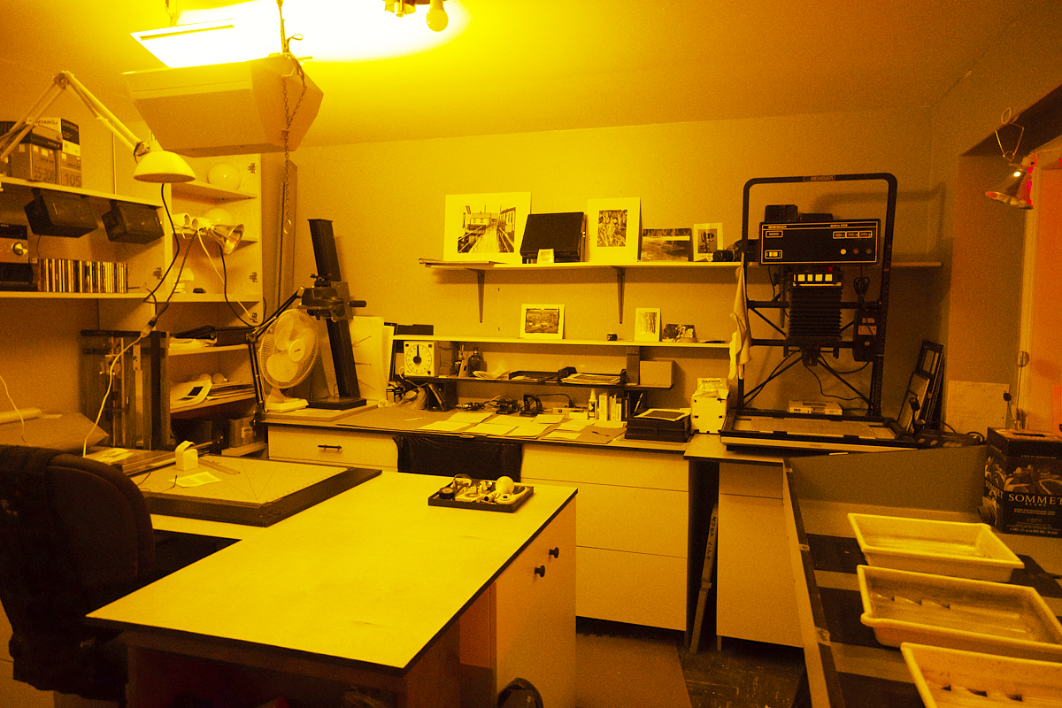

Couple quickie digi-snaps:
