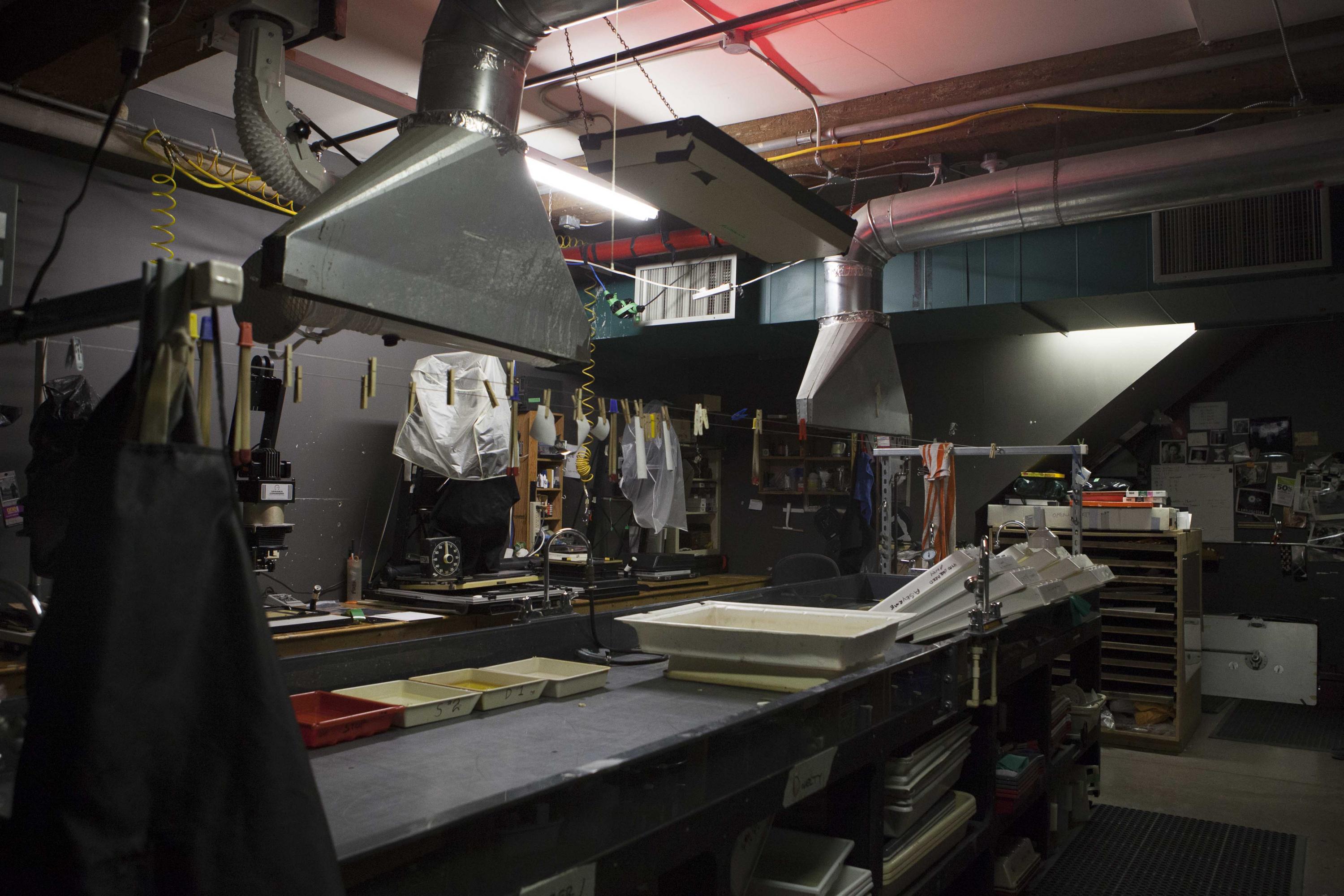

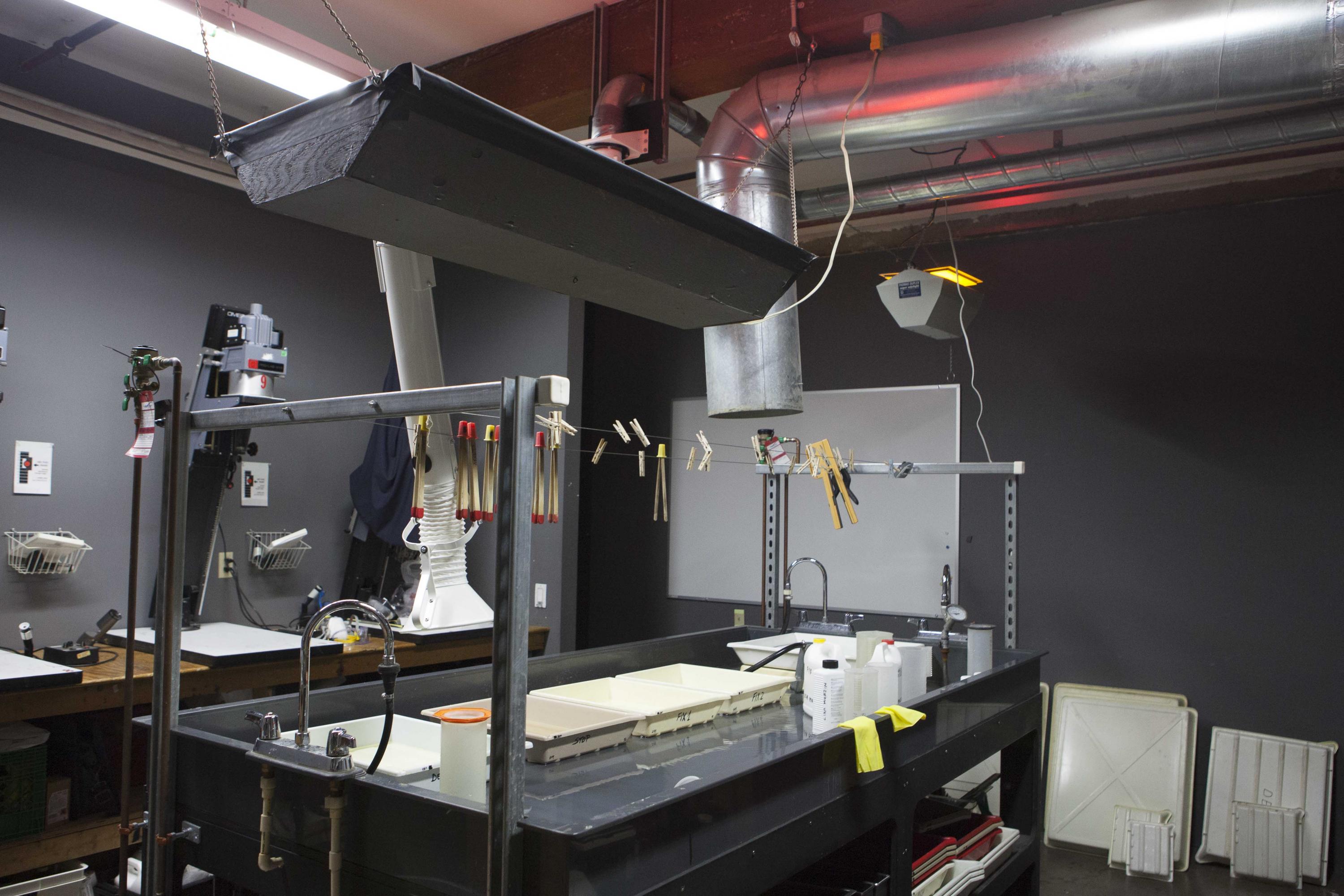

HI APUG
I am helping out at a not-for-profit artist centre in Toronto and the centre is looking to upgrade it's existing darkroom lighting system for two darkrooms. The current system is a mashup of kodak and ilford made safelights, fluorescent light boxes with rubylith filters, and darkroom 'safe' LED lights (safe for a limited time, varies from paper to paper).
The ideal upgraded system would be:
1. Dimmable (users of the darkrooms have noticed the existing 'safe' LED lights to cause fogging, so dimming the LEDs would allow for longer periods for paper to be out)
2. Selective so as to only illuminate the walking paths of the darkrooms and only portions of the darkroom being used.
The system would be composed of multiple built-LED arrays positioned in different locations in the darkroom so that the lights can be turned on/ off and dimmed depending the needs of the user.
So far, I have not come across any sort of pre-built darkroom 'safe' LED array, has anyone found anything like this? I am supposing the solution will have to be custom built, one idea is to repurpose LED stage lighting with red LEDs or with filters (http://static.bhphoto.com/images/images200x200/996876.jpg).
How would you guys go about this? Below are images of the two darkrooms.
Thanks for taking the time!
attachment.php
attachment.php

For walkways, why not red or amber mounted near the bottom of the tables or kickplates Reflected from the floor They won't give enough light to fog the paper. Spaced ~12-18" apart or even just on corners.
Is the afterglow from the fluorescents part of the problem?
