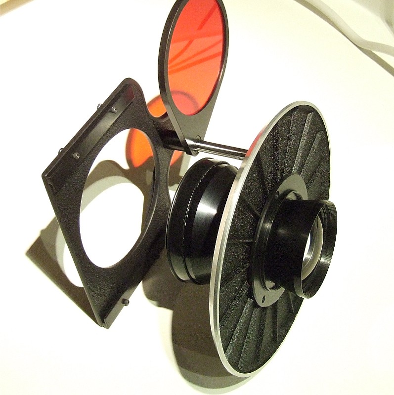

A friend is trying to resurrect an Omega DII. The lens cone has the piece to which the filter holder attaches, but no filter holder. I thought I'd try to cobble together an alternative.
Here's an example of the filter holder: http://store.khbphotografix.com/Under-lens-Filter-Holder-for-older-Omega-Enlargers.html
Can anyone tell me the length of the arm of the piece that holds the filter? From the hole where it attaches to the square section. Thanks.

The holes for the board side are 1 1/16 inch apart and I have see tapped holes and bolts with octagonal nuts and acorn nuts. The flat part that sits on the large board, and has the holes, is 1 9/16 long X 3/4 wide. The inside is curved to match round lens boards. The other side is cut in to 3/4 width to match the upright and the filter arm, but could be any width. The piece then turns 90 degrees on it's 3/4 width ans is 1 3/4 long . this then turns to the original plane on it's 3/4 width to 1 1/4 long. The end of this is rounded and has a centre cut out 3/16 wide x 7/16 long.

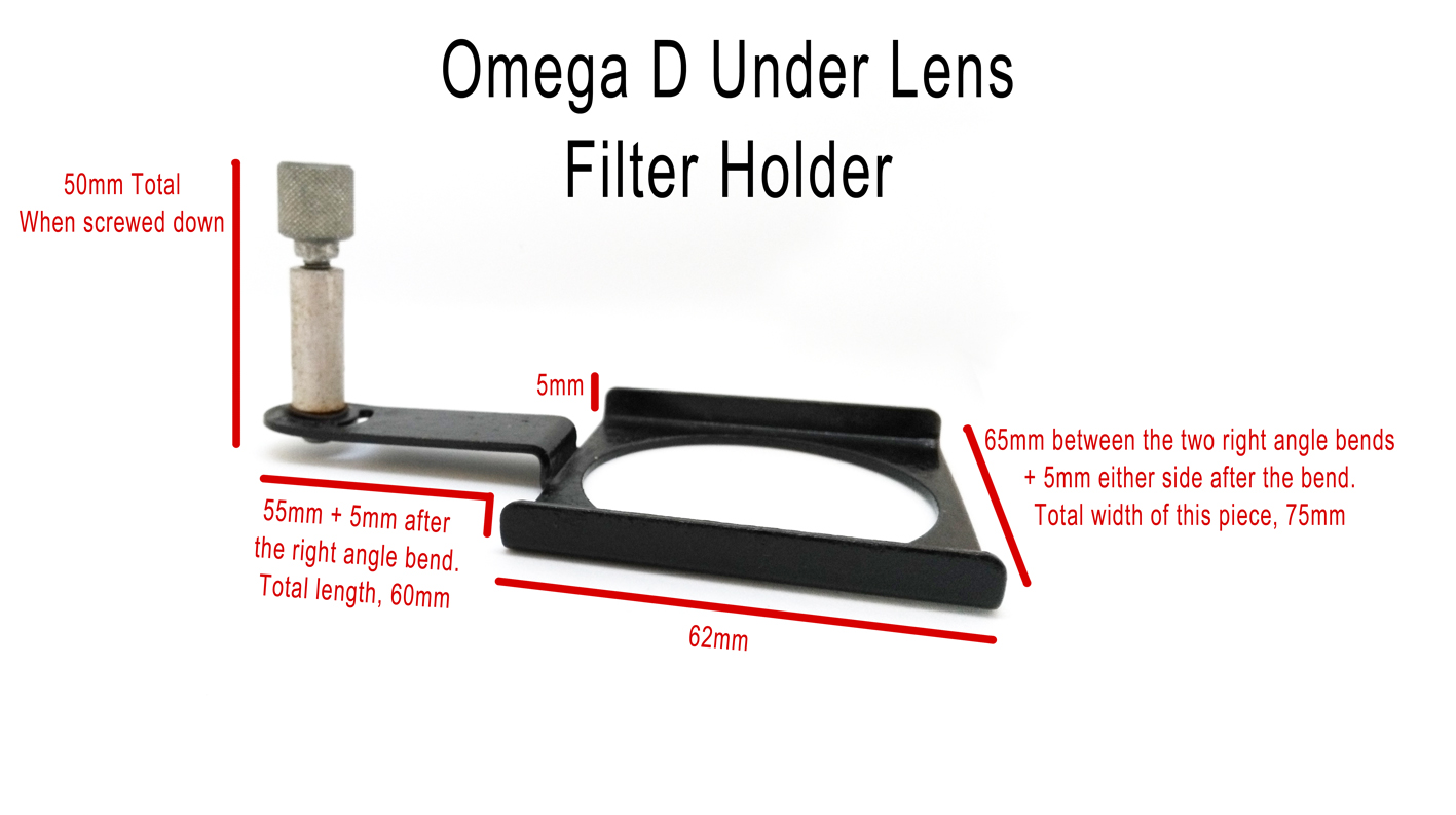

Hopefully this helps:
I'm not sure if it's entirely clear, but the "arm" juts out 55mm from the actual tray part, but the length of the metal itself is 60mm to account for that bend 5mm from the end.
Also, apologies for not converting the metric for you, millimetres were simply more precise at this size.

Pretty sure the "65mm between the two right angle bends + 5mm either side after the bend" adds up to 75mm total width, not 70mm as noted above.

All very helpful. I needed that 60mm (55 +5) measurement. And I can deal with mm.
My initial quick and dirty plan is to find a battery clamp of the correct size to mount to the existing "silver" post. That will clamp to the plastic tab on the Ilford 2" filter. Part 2 will be to take a thin piece of acrylic (plexiglas) to fashion a holder like ic-racer showed. I might even get fancy and make it double ended, with one end being a red filter and the other being the holder. Thanks to all.
