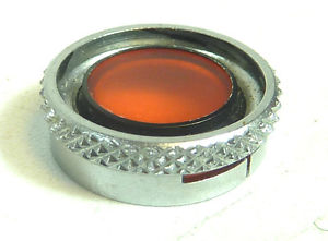

Yes, Leica did make such filters for use on LTM camera -- called ORAKO or OKARO depending on which camera you'll use it on (picture below).
But as we know, there are two windows on an RF camera: the main window we view and focus in, the the second window that provides the rangefinding function. A filter would "darken the primary view" if you put it on the primary window. Put it on the secondary window, as I and as I expect most others do, and the primary view is untouched.
