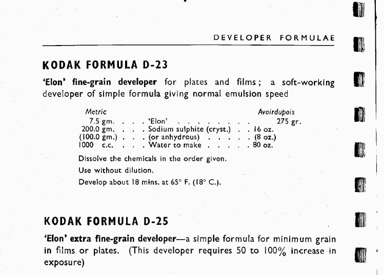

According to Eastman Kodak Research Henn & Crabtree formulated D23 to give rather finer grain than D76 (rather was Kodak's term) with only a slight speed loss. D25 was to give exceptionally fine grain but with a stop speed loss.
Both were designed to be softer working than D76.
Ian

The original source was Eastman Kodak Research Laboratory, an Abstract by Henn & Crabtree published in the BJP in 1945/6 and then abridged in the 1946 BJP Almanac. It appears Kodak Research Harrow had adapted/ammended the article to data for British made Kodak films. Whn I first used Tri-X and a Kodak developer the developer instructions gave speed and times for Tri-X made in the US. Canada and the UK, and they differed.

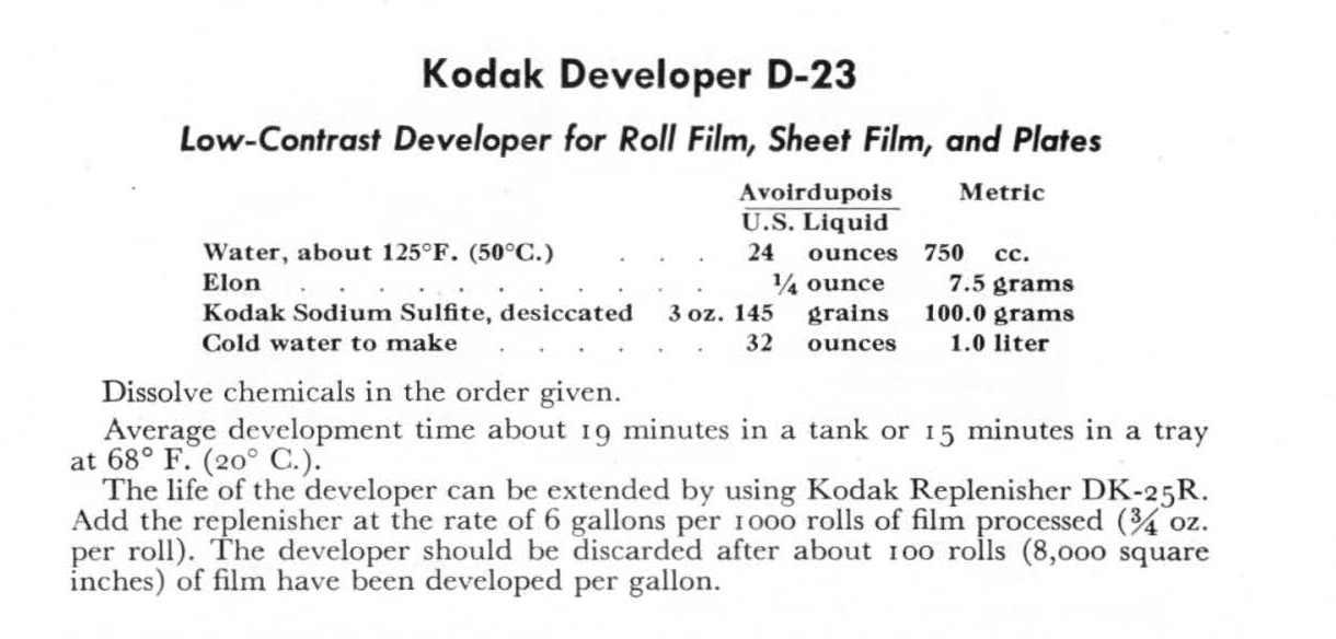

Soft working - Kodak's term, just means a lower contrast developer
Kodak Chemicals & Formulae, 1949. (Kodak Ltd not EK).
Kodak Reference Handbook, 1945, so Kodak Limited say Soft Working. EK say Low Contrast which D23 is.
Haist maybe contradicting Henn & Crabtree who were the experts in this field, the Microdol formula is in a pre WWII Henn & Crabtree Research Abstract and passed over in favour of Kodatol (DK-20) until there were issues with Dichroic fog and Eastman Kodak B&W films after the war. Here in the UK DK-20 remained a bit longer as did the later switch from Microdol to Microdol-X. British made Kodak films didn't suffer the same Dichroic fog issue, not sure about the Canadian Kodak films.
Ian

There appears initially to be a contradiction between Kodak's (EK & Kodak Ltd) suggested use of D23 and what Henn & Crabtree and later Haist say about D23.
Kodak are saying that D-23 gives finer grain than D76 when use as a Low-contrast/Soft working developer, but if you extend development it takes longer to increase the contrast and graininess rises.
Ian
