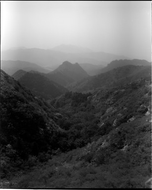

Anyway, the unevenness looks like this:
That's 6x7, so the film runs vertically. Sometimes you don't get the bright centre band, just brightness on the edges. It varies gradually along the length of the roll, which supports the mixing/exhaustion theory.

Funnily enough, film speed was not a problem at all! Though the negs look like there is practically no image on them, there is plenty of shadow detail. Mind you I was shooting in flat light, but there is detail on every part of every frame, i.e detail down to at least zone IV despite the fact that it got probably half as much development as it needed. While a couple of rolls are a complete writeoff, there was one shot I was looking forward to and was able to rescue with a bit of curve manipulation. You can see some other passable ones by traversing my stream from there.
So assuming it's an agitation (not film) issue, it shows that TMX has plenty of speed, at least in XTOL.
