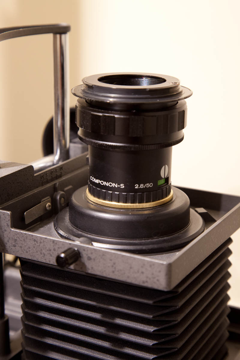

This is my setup.
A full-frame DSLR with a 50mm enlarging lens, a reversal ring and a Chinese helicoid adapter. The helicoid adapter converts the m39 of the enlarger lens to the DSLR mount and adds manual focusing. The enlarger bellows is used to set the magnification of the negative to the DSLR. The helicoid is used for manual focusing with the DSLR in live view. The (AN) glass negative holder of the enlarger keeps the negatives perfectly flat.
Since I only digitize B&W negatives, the color temperature of the enlarger lamp is irrelevant. The whole setup work well and it only takes a minute to change the enlarger from the normal print setup to the copy setup. My goal was to get a cheap and small solution to digitize MF negatives. I didn't want to get an expensive and/or bulky scanner. I digitize 645 negatives and use the files in Lightroom to catalog my negatives and it allows me to prepare for a darkroom printing session; determine crop (if any) and get an estimate of where to dodge and/or burn. I don't use the files to print digitally.
