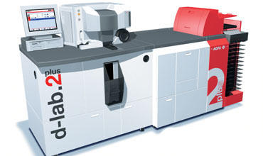

Because (I hope so) the resolution from the laser print system is above the losses
of scan and above the losses of any optical enlarger system.A typical machine to reach fabulous print quality is this here :
...the d-lab 2 plus from Agfa.
It reaches 400dpi print resolution with color deep of 12bit.
But the including scanner unit isn't the absolute best I must state.

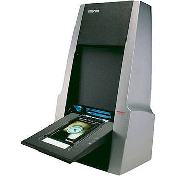

If you want to have a little more of all you should make your scan seperately with this scanner :
...its the imacon flextide 848 one of the best scanning machines ever built
The optical resolution is 8000dpi with 16bit. You also may have the possibility to make multi-shot scans to spread the resolution a bit more. (so if your software is able to handle the data of 400MB Tiff / frame x the multisssion rate.)
