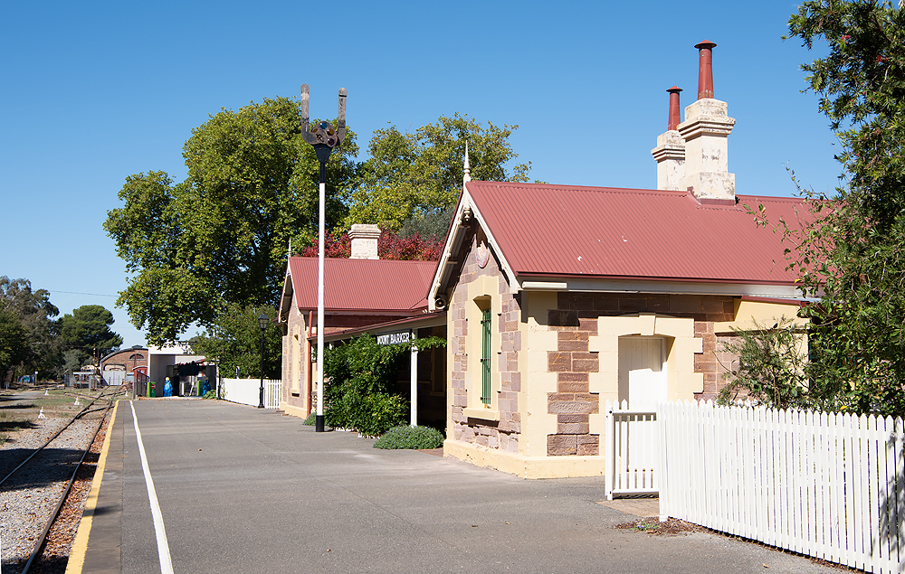

First a bit of background. I'm a old, long time film user, whilst I've owned a digital SLR for about 12 years it's just been a camera for a few quick snaps. I do my "serious" work on a 67. I've just upgraded to a Pentax K-70, not top of the line but, according to reviews, a very decent digital SLR. I shot this photo and when I put it on the monitor I noticed that the auto exposure had completely blown the highlight on the right doorway. To be sure, this was a very contrasty scene with the white fence and the deep shadows under the verandah but I'm quite sure anyone with decent B&W film skills could have obtained a neg with adequate shadow detail without blowing the white painted area. Of course I could have reduced exposure but that would have done not nice things to the shadow areas. I suppose I could have done a HDR and got a decent result. So what gives? Aren't digital sensors able to capture scenes with a big Subject Brightness Range yet in a way B&W film can?

If you shot RAW, you could easily tell the RAW conversion program (Lightroom, Photoshop) to reduce exposure in the Highlights, raise exposure in the Shadows.
With JPG, those same adjustments are often also possible, with a narrowed range of effective control of both.
Digital has often been characterized to be 'like shooting transparencies'..."DON'T OVEREXPOSE and lose details that cannot be recovered!" Newer digital sensors also have a slightly wider dynamic range than the early sensors could reasonable capture.

Assuming you are taking jpegs, the jpeg conversion in your camera most likely clipped the highlights. Take raw pictures and using a good raw processor, you should be able to recover a whole lot more in the highlights. Digital sensors actually can handle the highlights better than the shadows. That's why some recommend the ETTR method, which is "exposing to the right" of the histogram - analogous to the expose for the shadows and develop for the highlights.

Just a reminder that we have a prohibition on Photrio against most digital vs. film arguments.
On the thread topic itself, it probably isn't the sensor that is causing the problem, but rather the combination of the sensor, the firmware, the file type, the file conversion, and the software you are using to display the results.
It might even relate to the default (or other) settings you are using on the camera.

I edited the posted image (original on left, edited on right)...note even within limitations of JPG files, I was able to extract a lot of detail even in what was a black hole of detailess shadows!

Sorry, I should have mentioned that the image was shot in RAW and the jpeg you see was not altered in anyway by means of PS controls. The camera was in aperture priority mode.
So you captured it in RAW format - then what did you do, put it in CameraRaw? Helps if you can tell exactly what your process is before going into tangets trying to guess what the problem is. Not to mention starting another film vs digital debate.
So you have the potential TO DO BETTER what I demonstrated was possible by postprocessing the posted JPG!
Yes, captured in RAW, it opened in Camera Raw 14.2 where I accepted defaults and just clicked OPEN and then converted to jpeg for posting. Even though I'm a long time film user I'm a bit of a digital newbie. I've been a bit confused as to what Camera Raw is for, it always seemed a waste of time to me as it seemed to have the same controls as Photoshop. I've just watched a Camera Raw tutorial and it seems like some photographers do the bulk of their editing in Camera Raw. I've now opened it again in RAW and adjusted highlights and shadows. The highlight is better at -100.
I would like to hear what your workflow is for experienced digital photographers.
Adjustments with RAW conversion software allows the postprocessing flexibility across a wider range of control, compared to postprocessing of JPG data.
Both can 'do the same thing', but with RAW conversion software you can do it across a broader range of control. Camera RAW takes RAW files and converts it into a 16-bit workspace, while JPG editing is limited to an 8-bit workspace.
I made a really bad exposure error in my haste. to simply get a shot..
This is the best I could recover the grossly underexposed JPG
Fortunately at the time I was storing both RAW and JPG, so I could recover the screw up much better.

I've only ever shot in RAW but I just shot a jpeg and when I opened it, it opened straight into PS. I discovered a great side benefit of RAW is if you have the wrong settings on your camera (Tungsten light setting in daylight) RAW doesn't care and it's easily corrected.
Are most people doing the majority of their editing of RAW files in Camera RAW?

With film, you can always find more detail in the highlights, whereas in the shadows, you reach a point where no silver was harmed, and there simply isn't any more detail to be had.
Digital's the opposite-- you can always boost the shadows, ugly though they might be, but once you hit the maximum brightness of the sensor, you're done. There will be no more detail, just a solid, perfect, white.
Or in simple terms, with digital, expose for the highlights. Or shoot HDR and expose for highlights and shadow.
FYI, modern digital cameras appear to be approaching 12 stops of DR, with some medium format sensors charging towards 13.
The K-70 is rated at 10.3 stops, according to photonstophotos.net.

I guess the moral of the story is to err on the side of underexposure with digital, (which for an old film guy like me is hard too get my head around). I have been amazed that pics that looked bad as shot, in RAW, can come to life by a simple exposure and shadow adjustment in Camera Raw.
Thos DR figures are interesting, I think Barnbaum claims some films can go 18 stops, I've personally measured 14 stops with a densitometer. As you say, HDR can let you have your cake and eat it too!
