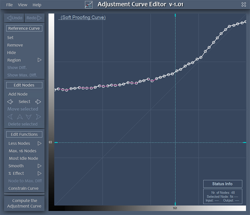

But I still like to see the effect on on actual image.
Me too, Tom. That's why I am using my "Soft Proofing" method for my DNs.
For me a question still remains regarding the adjustment curves : why, even when you have your monitor/scanner properly calibrated, the adjustment curve generated by scanning a chart will not always give the best possible results? Why is often necessary to make additional adjustments? The way the printer uses different inks may be an answer, but even with Quad Tone Rip you have to manually readjust the curve. The problem may not be so big with some processes (like Palladium, Platinum, VDB) but it becomes annoying wit Gum prints, for example. None of the adjustment curves produced by different scripts give satisfactory results for Gum prints. Probably paper inconsistency or the difficulty in keeping the process perfectly reproducible... All these can't be seen in a 16 nodes curve, as is the PS curve, but look how a 48 nodes response curve of the Cyan layer of a CMYK Gum print really looks in detail:
The magenta regions of the curve are descending. No descending regions should appear in a response curve, otherwise the adjustment curve is not properly computable. All the scripts for computing the adj. curve are, in fact, using all the gray levels of the chart (resulting in an 101 values response curve, in the case of ChartThrobe) for computing the 14-16 nodes of the PS adj. curve. None can produce accurate results if they start from a response curve with descendant regions.
One additional source of error is the scanner itself. In particular, there is an effect on the reading of a spot by the cross-reflections around it. So depending on the nature of the space around a particular block, the measurement will be different - by as much as 10% in L* value. Check this thread:
https://forum.luminous-landscape.com/index.php?topic=124885.0
Just in case you need to complicate this further....:smile:
