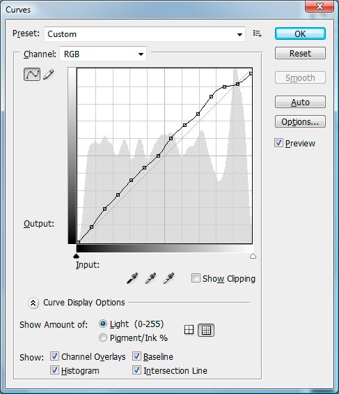

Oh with all this new digi-neg info I just had to give it a try. So I remade my kallitype curve with gamma=.5 and photo black in lieu of my usual mK. And here is the result......:D

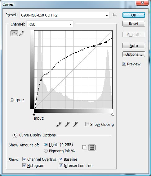

I was not doing pd printing back in the Chart Throb days. These are kallitypes from 2008. One is the original contact print, then the curve and then the contact print with curve applied. These are from an HP B9180 printer I was using at the time.
In looking the curved contact print, it looks a little underexposed. I poked around and could not find any of my old chart throb test prints. But I ran an analysis on the curved print and it came up pretty darn linear, just the blacks don't seem quite up to snuff.
