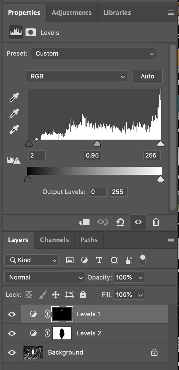

Here are the adjustment layers:

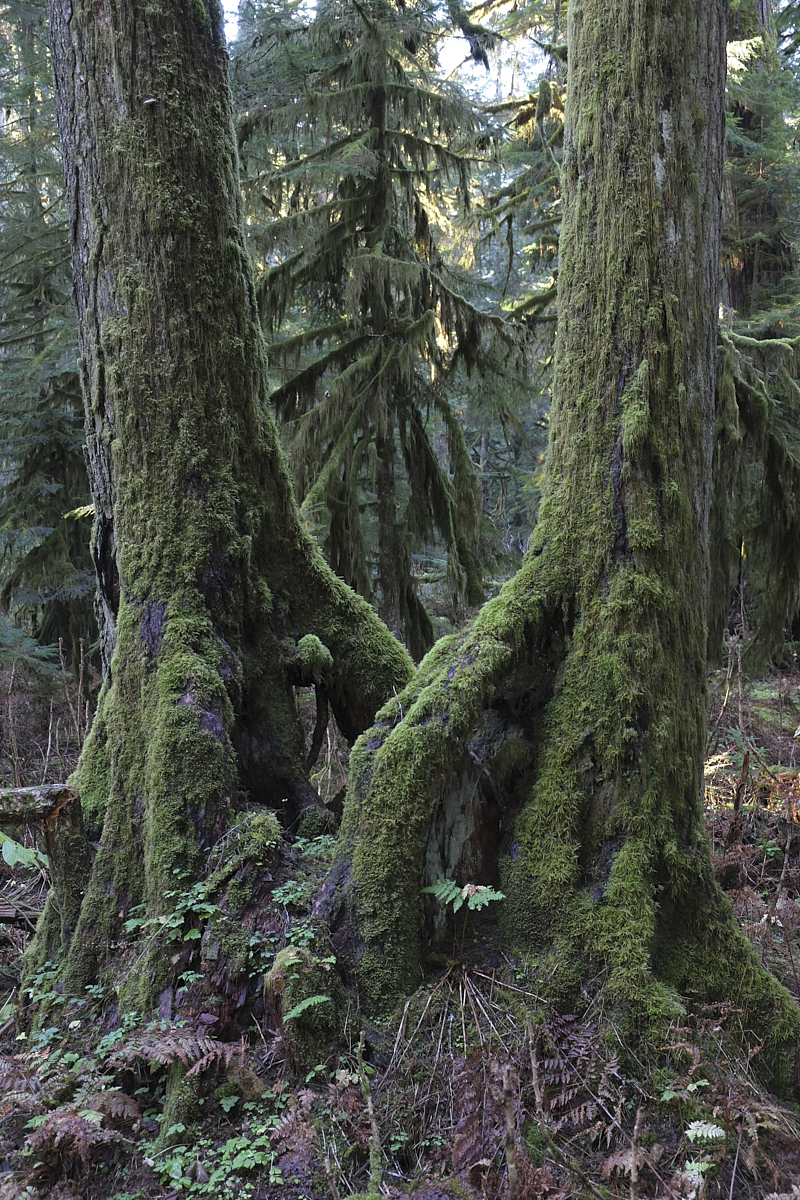

That's what I do in Capture One as well, with some tweaking of colours, making annoyingly bright and/or distracting bits disappear, selectively sharpening one area while slightly softening others to grab/direct a viewers attention, etc.
This is one example I've posted before: going from this...

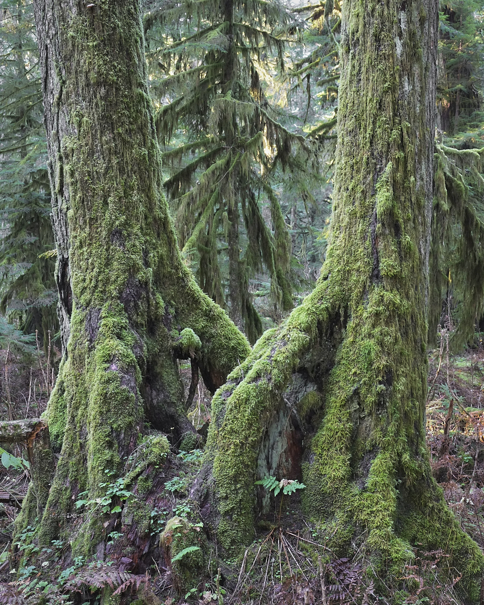

To this...
Trying to explain how would be futile...too convoluted! Best option might to search online for how-to videos with several editing programs; hopefully one will jump out of the pack and resonate with you.

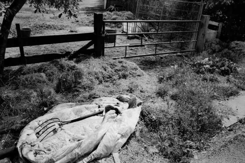

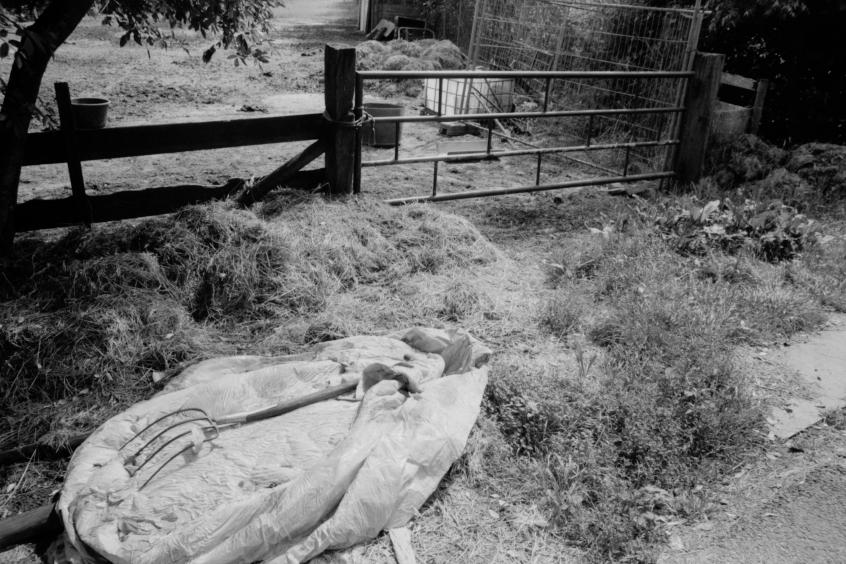

Here's a quick & dirty example. The image isn't particularly interesting; I only picked it because it lends itself well to the demonstration. It's also not intended to show how the end result may or may not be "better" or "more beautiful" than the original - again, it's just to illustrate the technique:
Source material: original scan from B&W 35mm negative, inverted with minor contrast adjustment.
End result, which is the following stack of masked layers:
I've named the layers to make them somewhat descriptive. Going through the layers from bottom to top:
  • The bottom layer has an overall contrast adjustment; that's the basis of the 'print'.
  • The next layer has a higher contrast version of the image that expands the tonal range around the midtones (i.e. shadows turn to black and highlights blow out). It's selectively masked to only show the bottom right corner and part of the hay in the center of the image.
  • Then a layer that expands the tones in the highlights, which is exclusively used for the plastic sheeting in the direct sunlight.
  • Next up is a layer that lifts the deepest shadows, in the top corners of the frame.
  • The final image adjustment layer expands the tones between the midtones and deepest shadows, which is used for the gate
  • The top of the layer stack is made in this case by a vignette, which is simply a gradient with black corners and a transparent center. This is dialed in for only ca. 15% to create a subtle vignette.
Going through the same set of layers, but now with techniques and approximate values that might have been used in the wet darkroom:
  • Base exposure at let's say grade 2.5, favoring the grassy area just in front of the gate. Let's say 15 second exposure time.
  • Burn bottom right corner at grade 5 for 3 seconds.
  • Burn plastic sheeting area with grade 5 for 7 seconds.
  • Dodge (during base exposure!) top corners for 3 seconds each
  • Dodge gate area at the top for 2 seconds or so
  • Finally burn the sides and corners of the image for 2 seconds

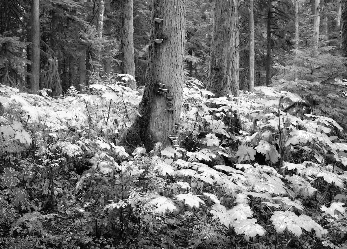

Here's another thing you can do in the dodge & burn department within the digital realm.
In the forest photo above, there were a few yellow devils club leaves in the bottom left corner which distracted from the wedge shape created by the rest of the devils club leaves.
To bring down their tonality I created another layer, masked just those leaves, went to the colour editor, then darkened just that colour. Click, click, click, slide, done. Much faster than pin registered masking!
Being able to adjust the tonality of any colour in a scene while making B&W images is a huge advantage...you can darken blue skies, then brighten yellow flowers, then lighten green foliage, then open up shadows by masking them and using a blue slider to lift all the tones, etc...
