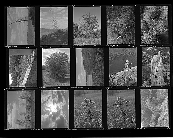

I've never been happy with contact sheets of roll film plus I prefer not to use up expensive paper for proof sheets. I recently tried proofing by laying out the negs on a scanner (Epson V700) in the 8x10 film guide area and I was pleasantly surprised with the result which is attached. I lay the negatives emulsion side down and flop them in the photo editor. I find it much easier to evaluate a photo this way. If the strips of film will not lie flat I simply put a thin sheet of glass on them.
