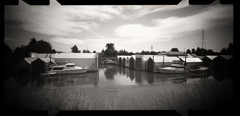

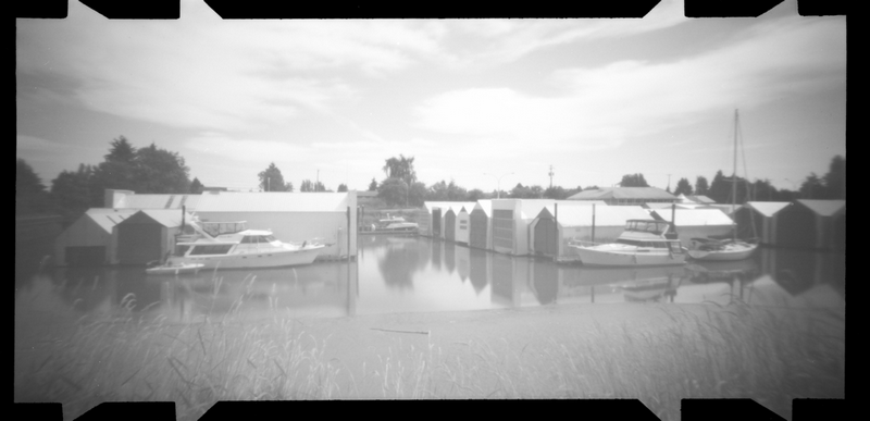

I have a Noons 6x12 pinhole camera. It is a beautiful thing. It is set up for 6x6, or 6x9, or 6x12 on 120 film. Much bigger of course than a 35mm frame.
I can make really satisfying darkroom prints from the negatives it provides, as long as I bump the contrast up a bit.
When I scan those negatives - which adds another bunch of variables - the unmanipulated scans look something like this:
After a bunch of digital jiggery pokery (specialized technical term), including ridiculous amounts of sharpening, the result looks more like this:
You are trying to use a digital camera to preview, but that gives you none of the jiggery pokery.
