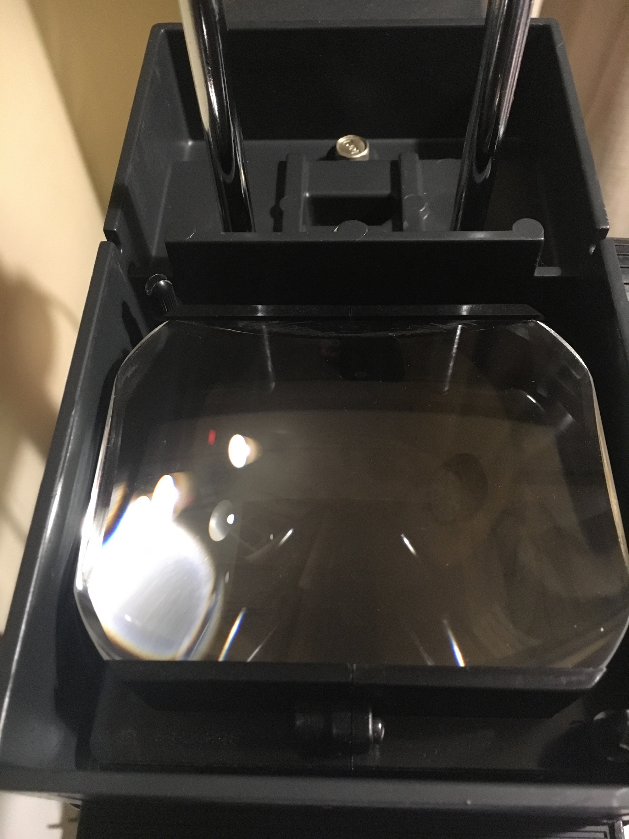

Juan. I have looked at my Kaiser Multigrade head (halogen) and it does have a diffusor plate. This is white, made of plastic and has a tab secured with a screw. The plate is not flat but is shaped like a pyramid (with a very shallow slope). If you have a look at your head you should be able to work out whether a diffusor plate like mine is designed to fit.
So a partial answer to your question is that the diffusor plate goes between the light source and the condenser. It is plastic but it is not a flat plate. Kaiser are very good about spare parts so if you e-mail them my photo they should be able to tell you the part number so you can order one.
Diffusor plate (view of the underside of enlarger head when removed from enlarger)
6x9 Condenser

Yours is part of the head. The OP is inquiring about a diffuser that (to his belief) makes part of a substitute-condensor kit.
The Kaiser V-enlargers are modular and one can change assemblies. Changing them in format or lighting system
etc.
"Integral metering" means metering the average luminosity or colour hue of the negative/positive, instead of spot-metering (a face, a patch or tarmac).
Aside of this diffuser plate there also is a heat-absorber filter to be placed in the filter drawer above the film carrier.
I advise the OP to look in the current Kaiser catalog. It lists all available parts and kits.
