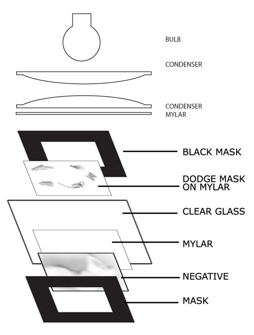

Troublesome neg I've been fighting with, realized a dodge mask would be just the thing. However, my enlarger's a 67C condenser.
So, I ended up with the configuration below... good heavens, a dodge mask is pretty magical, just the thing, and even on 6x7 I can make very smooth gradients with a pencil and some rubbing/erasing.
But... I'm getting some extreme falloff - some corners are going almost pure white.
I didn't have any opal glass, but plenty of frosted dura-lar mylar, same stuff that's sold in masking kits. So my "stack" uses an extra sheet of mylar to get enough separation/softness to make the mask seamless.
With my sekonic meter, I tested the 6x7 area (empty neg holder in the enlarger) and found I have about a half-stop of falloff (Nikkor 5.6 85mm lens) when setup as the stock condenser enlarger. When I do my custom-glass-negative mess, it's bizarre... bottom edge and top left corner go almost white, like a shadow is being cast??
I added a sheet of diffusion under the bottom condenser (tried it in several places, filter drawer and under the heat absorber). Same results.
Added a mask to the top of the stack as well... still getting this extreme falloff. Any ideas as to what's going on? See the diagram - I'm not using the negative carrier at all, the glass is the same size as the full 6x7 carrier and masked to 6x7 with black heavy paper.

I placed the neg carrier in the enlarger and traced the position on the baseboard, and made sure my 6x7 masks hit the same spot.
The glass I cut is the same size as the carrier, and the masks are taped in place - so even though the glass doesn't have the slots that align with the pins in the negative stage, it's within a few millimeters of the correct position.
I've already modeled a glass-holding carrier for 3D printing (the beseler 67 series doesn't have a glass carrier available) but I want to figure out what's causing this falloff before I commit.
I was wondering if the edges of the glass are scattering light, but seems that would give me problems with dark areas, not falloff? Or the fact that my neg carrier is essentially a big sheet of glass with negs and masks just sitting on it? If I have a carrier printed with a frame for the glass at just slightly bigger than neg size, that would address that by enclosing the glass in black. If the "well" for the glass is the same thickness of the glass, I'd still have plenty of margins for taping masks that could be hinged up and down. The neg itself would be taped to the bottom of this carrier idea.
Also, the fact I'm using clear glass vs. frosted or opal? But the glass is sandwiched top and bottom with mylar, so it's essentially frosted glass.
