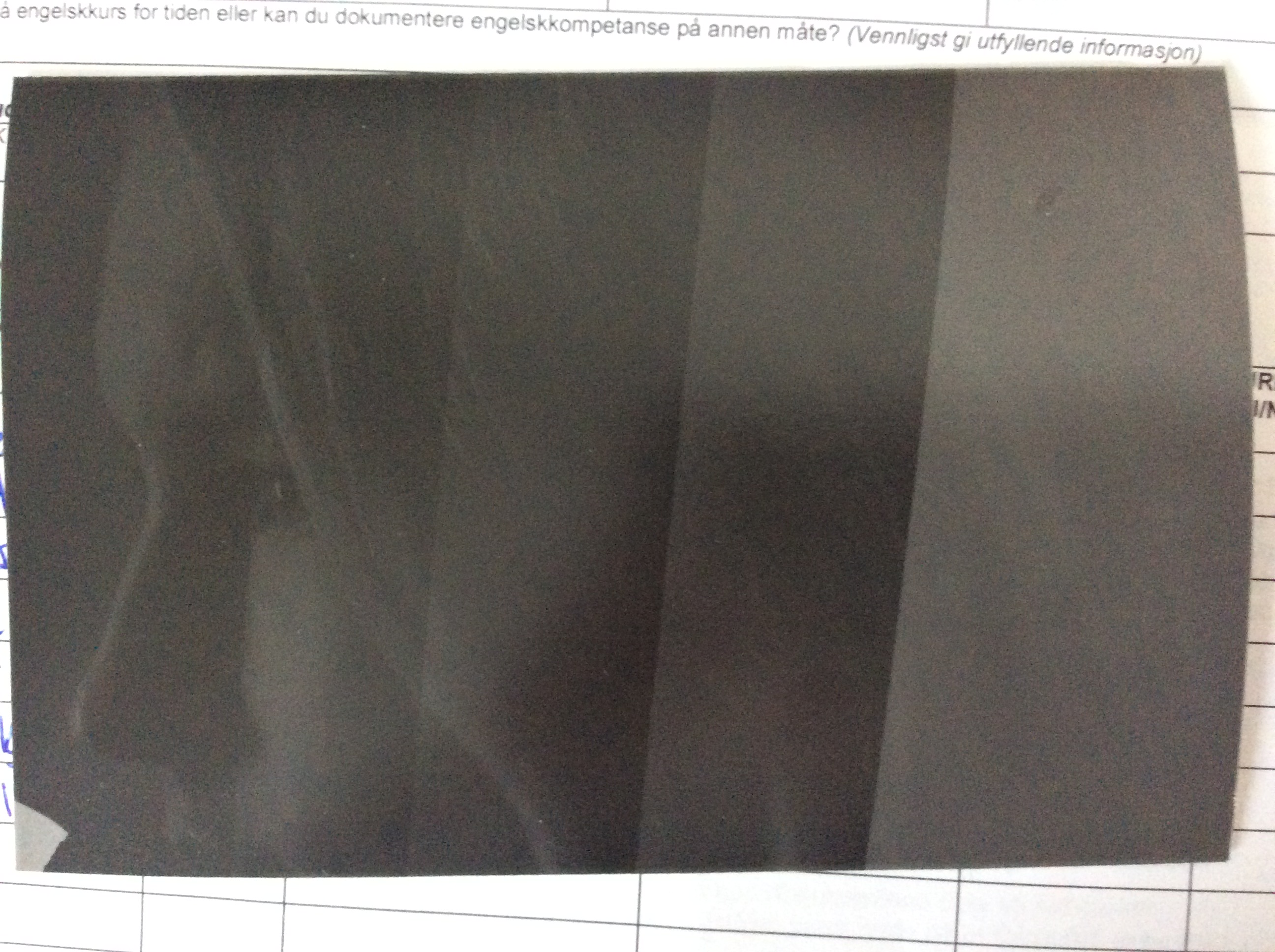

so I received some new paper for Christmas. Previously I've been printing on ilfords classic fibre paper and went to print some of the same negatives today on the RC pearl. Everything came out super grey?
Could this be due to old or tainted dev?
At school, all we have is hc110, which is maybe not ideal either (?) but so far I've had no real issues with it.

bdial - I can't remember if there were true blacks, but my test strips had very little contrast and were just varying shades of grey getting darker and darker, without the contrast or whites to give it definition. I can try fish them out later today. Borders were still white so no fogging. Was a new pack, and was careful.
My previous RC (not pearl) prints were fine, so I assumed it was a dev problem.

These negs are a bit thin, but I didn't expect such a change. The only differences were age of developer and paper type. Will try again tomorrow with some good paper dev :smile: was supposed to try tonight but ended up developing some sheets after shooting and ran out of time.
Will post a test strip from the RC pearl so you guys can see what I mean by grey

Test strip Pic attached

It's grey alright. :smile:
It would also be helpful to show us the negatives, un-reversed, as you mentioned that the negative is thin.
There is no reason the RC can't produce a print similar to your FB, I've routinely used RC for tests and proofs for my Ilford fiber prints, though the emulsions have diverged some in the last couple of years.
But, you have a few things working against you to figure out what's going on. That is, a thin negative, and using film developer on top of working with a different emulsion.
Please tell us the details of this test strip, paper or film developer? What filtration, if any, was used?
The problem with thin negatives is that the highlights need a very short exposure to stay bright, and that exposure isn't long enough to get a true black for the shadows. Increasing the contrast filtration helps, but there is a limit

Take a photo of the neg on some sort of light table? Or maybe even scan it in as a photo? What's best?
I'll have to look in my notebook later to check, but I believe it was contrast 2 (we have an annoying durst enlarger that only has a scale from 1-5 rather than individual adjustments). Ilford multigrade paper dev, 1.5 mins.

Stating the obvious, there is clearly something wrong. If I had only been shown the print and asked to comment I think I'd have said that the paper was very old. It somehow has the look of a paper that has lost most of its contrast.
Others might be able to decide on the problem from the picture and what you have said already but it might help if you list all the details you can about all of the ingredients again that were used in the very grey print including age of paper, age of developer( freshly made before printing) etc
We need to be able to eliminate each factor. For instance if the developer is new, was freshly made for that print at the right dilution and the right temperature and print developing time then we can eliminate developer as the cause.
It is laborious and may involve repeating information you have already given but unless it on one page and in one post then solving the problem is very difficult.

The paper was bought new at Christmas, the dev was old (about 15 rolls of film already developed in it) and was Kodak hc110 sol. B. It must have been the dev as I mixed a fresh batch of ilford paper dev yesterday and the prints with the same paper were fine.
Are you saying you are re-using HC-110 dil B?
HC-110 is intended to be used one time only - "one shot". Unless you are using it with the special purpose replenisher, which is no longer made (and fairly complex).
And it is a very bad idea to take developer that has been used for film and re-use it for developing paper. Or to do the reverse. In either case, the byproducts of use for one can interfere with developing the other.

That is probably why your test print was so bad was because of an underdeveloped negative. Read the instructions with the developer HC110 they are very clear on their limited life once mixed. Should just start over with fresh film developer and print developer and don't mix the 2. Yes I have used Rodinal diluted 1-10 for prints but it was only a temporary issue until I got new print developer. Also I see after 15 rls of film you are way past the end of any one shot developer. Negatives are too late to recover but be careful with your next ones.

Interesting, I thought hc110 at that dilution was reusable for developing film. I don't think my school would be ok with us using it a small a one shot developer, they don't seem to want to spend any more money on the darkeoom as is unfortunately... cons of the digital age :/
My negatives
Since I started printing have been much better as I am now developing and shooting with printing in mind. These negs were older from when I was only using a hybrid process (scanning). The dev. I judge on colour and how many rolls its been used for, so far so good with reusing. It usually gets thrown out after about 15-20 rolls.
