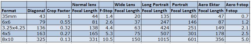

Suppose you have a normal lens on a 35mm camera (44mm, f/1.4 say) and you want to take an identical picture with a 4x5 camera (except for the slightly different aspect ratio.) You want the field of view and depth of field to be the same, and you'll stand in the same place.
You work out the crop factor which is the ratio of each format's diagonals. You divide the focal length of the 35mm lens by the crop factor and you multiply the f-stop by the crop factor. This will give you the lens you need to take the identical picture.
So you would need a 165mm f/5.3 4x5 lens to take the same picture and an 81mm f/2.6 lens on a 6x6 Rolleiflex. If you had a Speed Graphic with an Aero Ektar attached, your 35mm friends would need a 47mm f/0.7 lens in order to duplicate your photo.
Here is a conversion table just made:

Different formats have different aspect ratios, so different diagonal angles of view even when the horizontal and/or vertical angles of view are the same.
So i think you have to add two more tables.
If we assume the lens for 35 mm format to be "1", the factor for 6x6 is 1.57, for 4x5" it is 3.53, if you want the same horizontal angle of view.
In your notation, that's a crop factor of 0.63 for 6x6 and 0.28 for 4x5".
If we assume the lens for 35 mm format to be "1", the factor for 6x6 is 2.36, for 4x5" it is 4.24, if you want the same vertical angle of view.
In your notation, that's a crop factor of 0.42 for 6x6 and 0.24 for 4x5".
