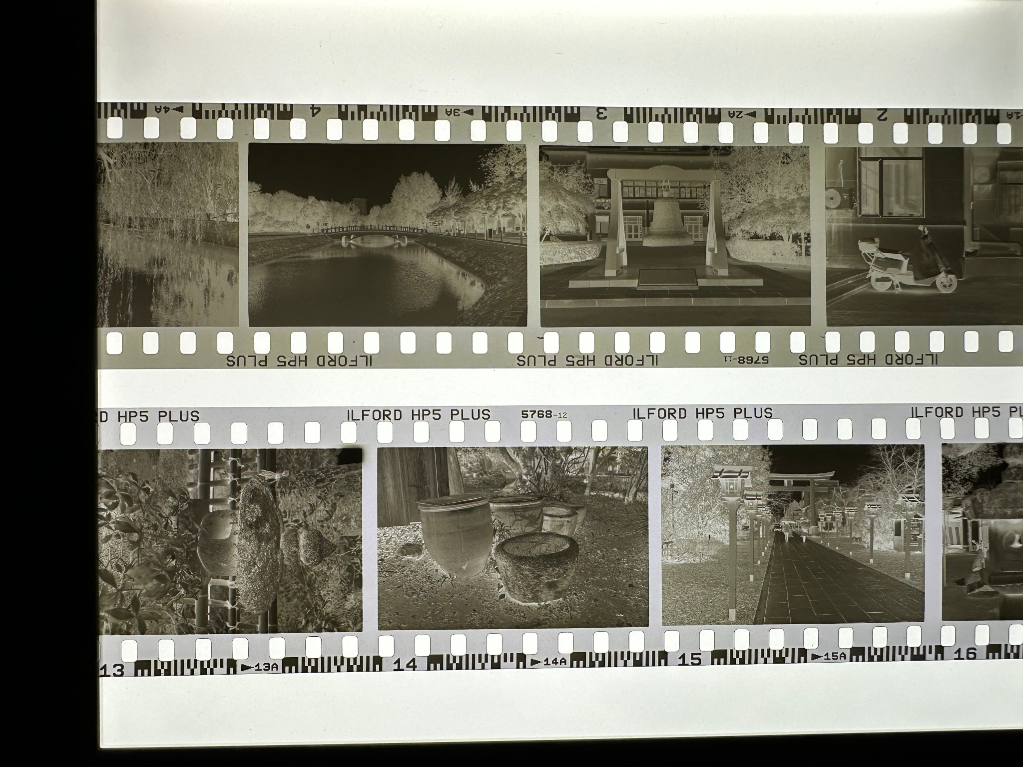

Hello to everybody.
I have recently developed 4 rolls of HP5+ in the same tank (i.e., same developer, time, agitation, etc.) and one and only
one of them has a higher level of fog+base than the others. See the attached picture. I would like to understand why
this happened.
I am quite sure the rolls were not expired and that they may have the same expiry date (2027).
The only difference is that the roll with the highest fog+base level has made an additional travel by plane. Let me summarize:
- one roll hasn't traveled by plane (shot with a Rollei 35)
- three of them have been in Kyoto (BCN-Abu Dhabi+Osaka and back) (shot with a Leica)
- one of them (the fogged one) has and additional travel (BCN-Schipol-Beijing and back) (shot with the same Rollei 35).
So my question is: can x-ray fogging be the cause? As you can see, it is uniform along the whole roll. I have always thought
that x-ray fogging produces wavy patterns on film.
In the past I've had cases of high base+fog rolls, but I had always thought that the reason was that they had been in
the camera for too long (sometimes years). I'm sure this is not the case.
Any suggestions?
I have one roll that came with me to China and I don't know if I should use it normally or reserve it for experiments.
Definitely. You've got a case of CT fog.
That's the case with the regular/old fashioned x-ray inspection machines, which virtually never result in noticeable problems anyway. But CT scans result in significant amounts of overall fog, exactly what you're seeing on your film.
Especially when going through CT scans with your film, request a manual check! This is virtually always granted in Western countries.

I'am afraid it was at Schipol, where I explicitly asked if the machine was safe (it looked to me it was a CT scanner) and the guy there say it was. In Rome-Fiumicino they have a separate line for film and in Osaka they do manual inspection.
Does anyone have experience how to get manual check in Schipol?
Exactly. It’s radiation fogging.
It’s in your best interest to request hand inspection, not allowing any film - especially fast ones - to be exposed to airport scanning equipment. There are no ”safe” scanners.
That said, the fogging you see on your negatives isn’t severe enough to impede your ability to get good images from that film.
That's an unfortunate miscommunication or misinformation by the security personnel. Schiphol does indeed have the newer CT machines and they will demonstrably damage film the way you've experienced. However, people traveling so far through that airport have all received a manual check if they asked for it.
Did you ask if the machine was 'safe', or did you specifically ask for your film to be hand-checked? I'd suggest the latter; the former may just trigger second-guessed nonsense answers from security guards who really don't know about film.
Also, whenever possible, try to avoid that particular airport. It sucks in pretty much every way.

Yep looks like that roll got zapped by the CT scanner. It's damaged but you should still be able to scan or print photos from it.
The best thing to do is to explicitly request a hand inspection of your film. These days I travel with all my film in a ziploc type bag, for convenience. I get it out at the security line and wave it about, asking if I can have a hand inspection. On one occasion recently I was told I didn't need to put liquids through separately and I explained quickly, "It's photo film. I think that's a CT scanner which will damage it" and the security guy immediately realised he'd mistaken my bag of mostly yellow boxes for liquids. Perhaps that's what happened when OP asked if the scanner was "safe".

I have them in an old school lead bag but even with that and old school scanners I see an increase in fog. Schiphol always allows for hand checks (for me) but the Airport in Toulouse simply refuses.
A lead bag will not be adequate to protect 400-speed film from CT fog. The Bessanova/ADOX test demonstrated this.
hand it in to a different colleague who then scanned the rolls through a separate, 'film safe' scanner
I've never had them take it to a different XR machine.
In April I just handed my two bags of film (pictures of tulips and windmills, of course) to the attendant and they whisked it over for sniffing (yes, its a mass spectrometer/gas chromatograph and looks for explosives/incendiaries, not drugs).
The thing about traveling with film is that you have to pay attention, they won't warn you or protect you, and, in my experience most machines have no warning signs on them (a few do). If it's a CT scanner I always ask and have never been denied. If it's regular XR machine and in a hurry I might skip that, but if I ask they will hand check. Some people say they keep a roll of high-speed film in their cache as an excuse.
Regular machines are a risk too, but it takes several passes to see significant effect (usually...).

An update on the issue.
I filed a complaint about the damaged film to Schiphol airport. I exchanged several
e-mails with the claims manager, in order to clarify the circumstances in which that happened.
Here I quote two sentences of their last one, which I think could be relevant to other film photographers:
"We advise passengers to request for a manual check of films at the security checkpoint and
the security agents are obliged to check manually in case a passenger explicitly asks for this.”
“We’ve brought your complaint to the attention of the security companies at Schiphol to prevent further damage in the future.”
