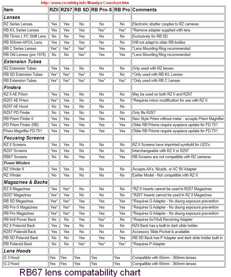

Here's a cross-reference chart for RB67 and RZ67 cameras, lenses and auxiliary equipment.

Here's a table of some of the C lenses. It would be nice if there were a list including the earlier pre-C lenses, and the later lenses too -- barring that, just lists from the Mamiya product literature.
