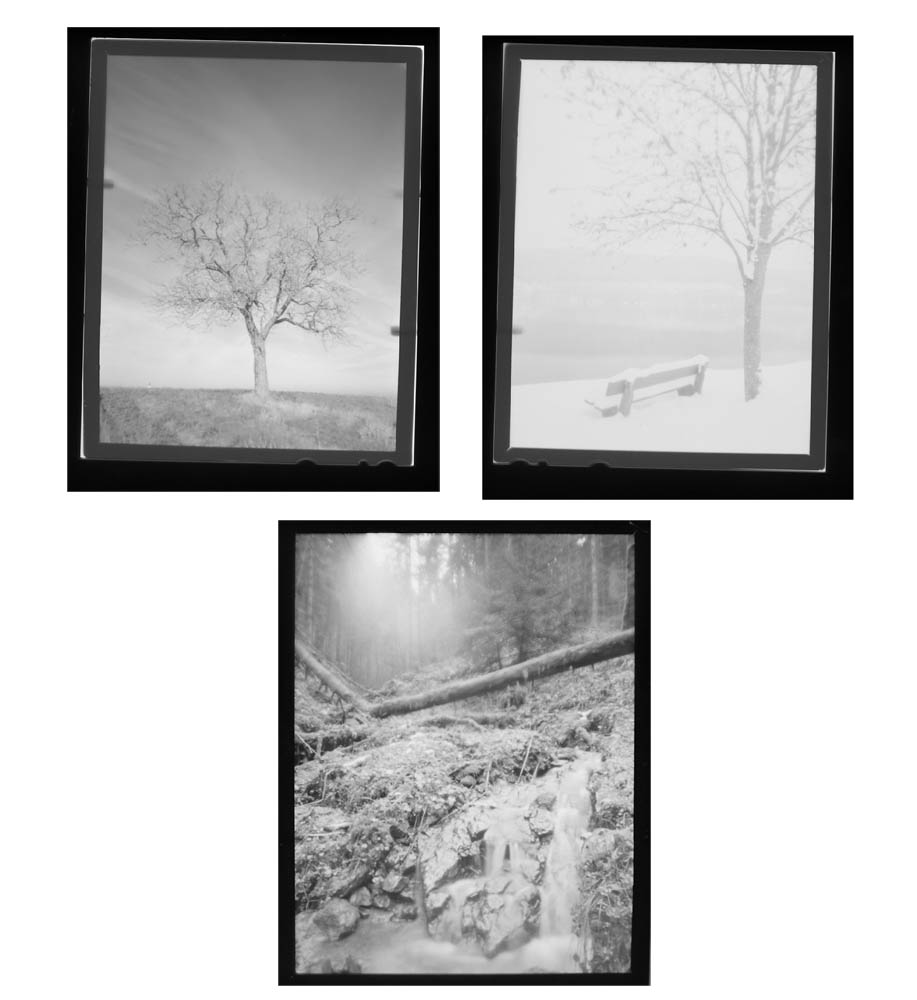

I developed these today with Rodinal.
I sacned the negative and converted it on positive on photoshop. Noting else.
Does it look good?
I don't know if it is because I was used to scan 120 and 35mm with "film negative mode", and now because of the size of the negative I can only scan as it were positive, but I am not used to see this kind brightness result.
I will make contact print of them tomorrow.
I also agitated different this time. Instead of making half turn I turned the tank upside down on each agitation. But I guess the impact of the developer on the negative, pressing it towards the negative holder, left those marks near the border of the image.
And for the seccond time I got this bright spot in the image, like on the button image. It wasn't the sun because it was a dark cloud day.
But it looks better.
