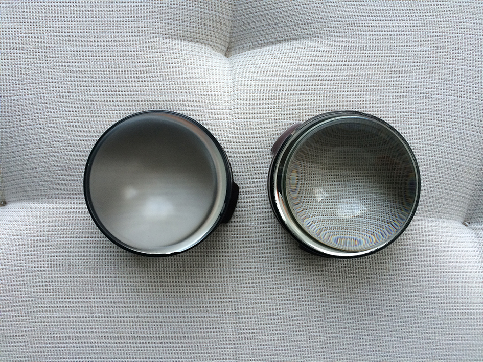

Greg, it does not always makes sense to insist on finding the cheapest solution. The fact you want to print using a 8x10 enlarger gives away you want to work at a high level. That often comes with a price. I suggest you first try to find the original AN glass of your enlarger en tell us the brand of your enlarger. You will be surprised what folks have laying around and will be willing to part with. Also, people may have suggestions where to find it.
Create search alerts on the auction sites.
For those who are unfamiliar with what AN glass looks like I attach a picture of two Leitz Valoy II condensers (which make direct contact with the glossy side of the negative, pressing it flat). The first version is clear and nor AN. The later version was AN treated.

I have never seen a Leitz condenser with AN treatment. Only the AN attachment that is added onto condenser. Live and learn. Does the AN condenser lens predate the Focomat?
You missed where I say these are condensers for the Leitz Valoy II enlarger. Not the Focomat Ic. The Valoy II was developed parallel to the Ic. They share the same negative holder and the same Focotar lenses. The Valoy II has no automatic focus and instead a very efficient large helicoid. The later grey version came with the AN condenser.
