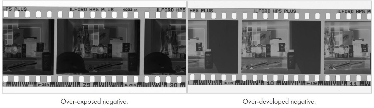

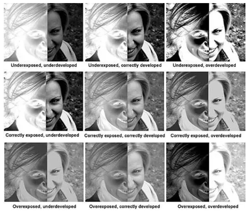

For B&W film problems here are a few images that might help.
Have a look here at the Ilford website for more details.
B&W common processing problems
And for C41 colour negative have a look at this link.
Color Negative Film Processing Errors
