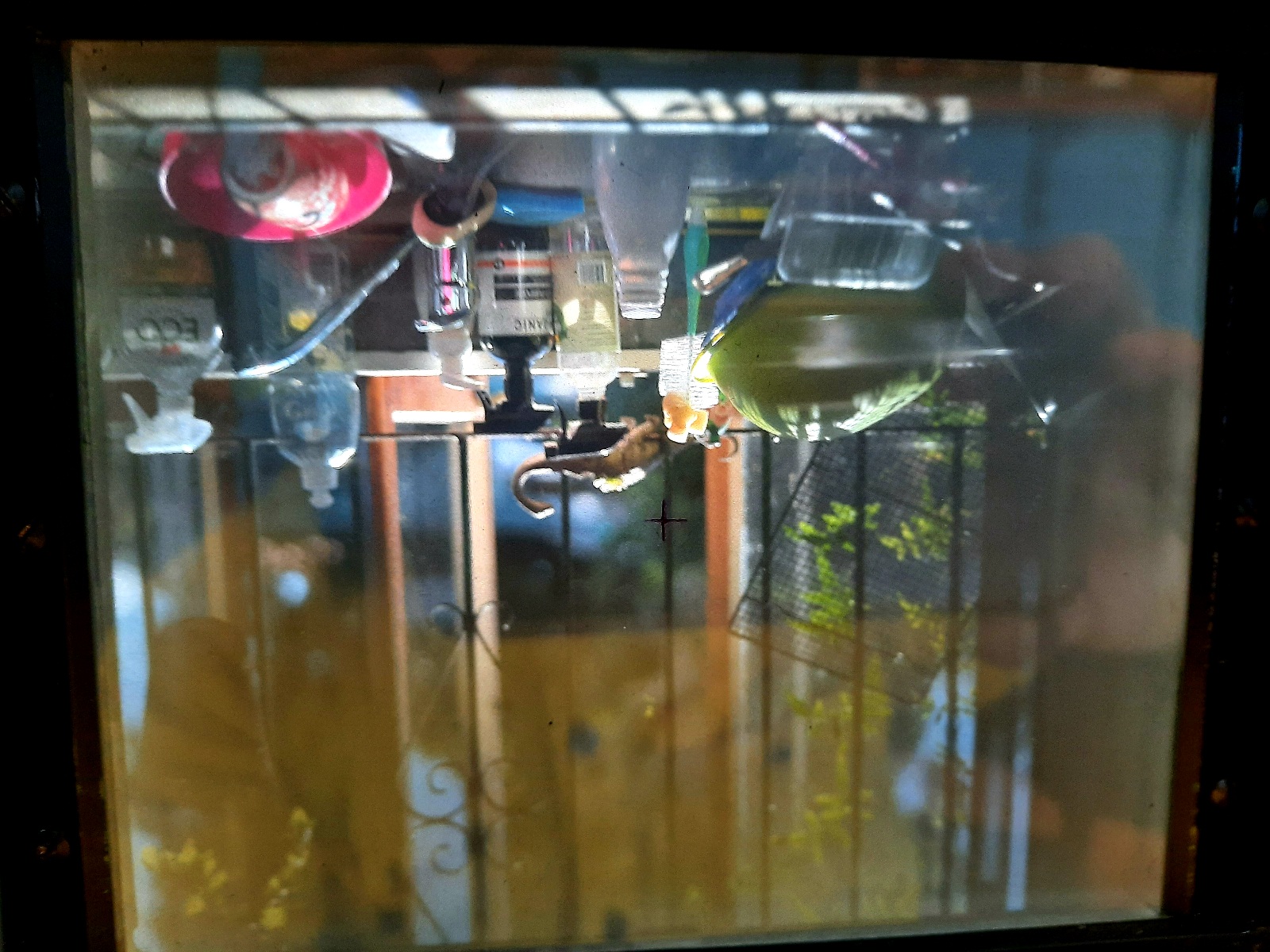

Hello! I'm restoring my Linhof Technika III ver. 5 which did not have a fresnel lens when I got it. It doesn't seem to be designed to take one, as putting both a GG and a fresnel in the little compartment area gives literally no room to adjust the focus position, and that doesn't seem like something the factory would have done on purpose.
So was the tech III not designed to take a fresnel lens? If not, what's the best way to add one?
Edit: my camera's serial number is 59752 as per the cold shoe, which places it roughly around 1953 ish from what I've read.
thanks!

It seems to have been a accessory to be bought extra. No hint at an extra thin groundglass, but just one thickness to be used with and without fresnel lens.
The fresnel lens was to be put from the rear onto the already mounted ground glass.
It seems that when the Technika III was introduced, the fresnel lens not yet was available as then there were not yet hints at such.

I don't think so because using my calipers (which are cheap but should give some idea), the max space available is 2.4mm, and the gg that came with it is .9mm, so that leaves only approx. 1.5mm to fit a fresnel and have some adjustment range, and even then the leaf springs are almost completely squashed, which doesn't seem right. Without a fresnel the GG (and leaf springs) have much more room to breath and be calibrated, which seems like the way it was supposed to be.
whoops sorry agx, didn't see you there. That feels maybe a little more right. I think the .9mm GG that was in the camera might be original since it's so thin.

Later Technikas mounted the fresnel between the ground glass and the photographer, and is easily and quickly removable. Mine came with the fresnel, and it’s still in the box—I’ve never used it, never really found it necessary. Mounting between the ground glass and the lens changes the focus doesn’t it?

Yeah, I've heard that only earlier technikas had the fresnel on the lens side, but I'd like to know which years that was done in! I'd like to try the fresnel on mine since it's pretty dark without. And yeah, it changes the focus, but I assume that back in the day you'd send the camera back to the factory to have it reshimed to accommodate the fresnel, if indeed it was mounted on the lens side.

If the camera would have to be readjusted after mounting the fresnel screen, it would not be listed as a pure accessory in the pricelist for the Technika III, when for the lenses the cam machining is hinted at. .
