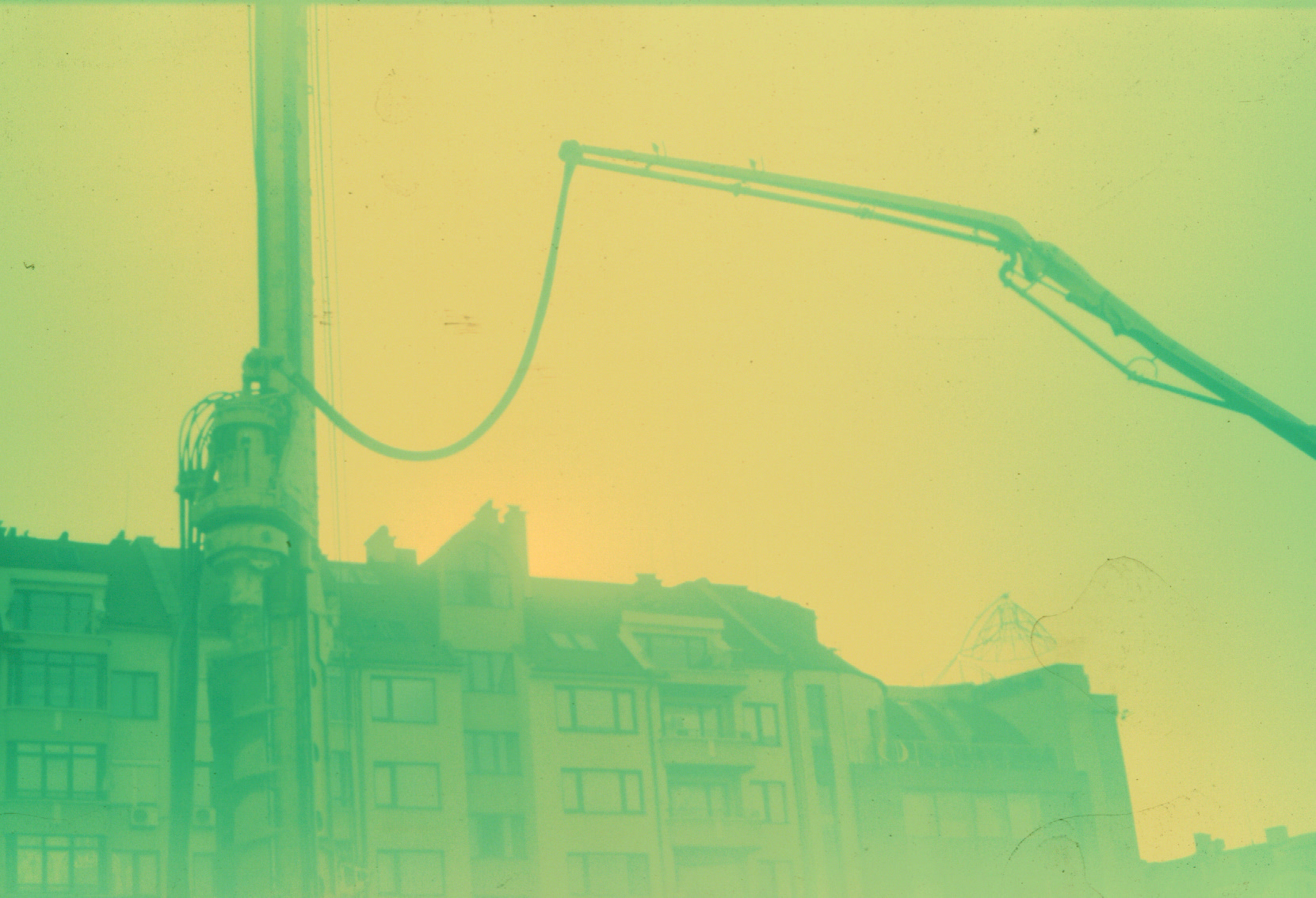

Ok, progress this evening:
UK17 (40ASA) shot as 3ASA, first dev is Rodinal 1+25, 20 deg C, 11 min, 10 or so agitations every minute, and the B&W negative got much denser, with lots of contrast. Then washed, stopped and exposed for about a minute 5cm from a 40W bulb, both sides. Then spooled and souped in diluted RA-4 dev until what I considering to be "completition", i.e. it didn't darken more. I removed it when it was completely black, then washed thoroughly and bleached. Then fixed in fresh C41 fix (from Digibase C41 kit).
The film is now much less dense, with saturated colours and distinguishable highlights, but no blacks, only greens instead of them. I guess either colour dev was insufficient, or exposure to light.

Please see the attached image. Do you believe that more contrast in the first dev would be beneficial, or should I really increase colour developer only? The source of the uneven colour cast is unknown, since I was agitating both developers.

Here is another one. Some "darkening" in CyberView X.

adash, the color reversible process, as in fact all processes of photochemical processing, it is important that you get black and white. The remaining intermediate tones will come by itself.
For this it is best to use a gray scale test.
In reversible processes (b & w and color) first development is the most important.
The images do not see any black (perforation film). Is down the black from my eye. Time or temperature change at the first developer until you get a good black.
Chromogen developer dilution will lead to a decrease in the final image contrast.
In your images I see a low contrast, so an increase in chromogen development time will make the image more contrast.

I didn't quite understand it. There were good blacks after the first developer. Should I add more development time to the first developer?
OK, I will try that.

Ok, next step, Rodinal 1+25 11min at 20deg C, RA-4 beyond completion. All rest is the same, except some more overexposure. Metered as 1.5ASA in the shadows.

I hope that this will reduce the fog, that whites are cleaner.
Another option is to use b&w developer (Rodina) concentrated (1+ 15) for 8-10 min at room temperature.
George

Dimitar, I would suggest you use before the b&w develator a prebath - sodium carbonate 20 g / l. Time = 3 min. at room temperature.
I didn't follow your advice on that, since washing soda isn't so abundant here. I usually heat baking soda (sodium hydrogen carbonate) instead, but now I went in another route and tried HC-110 in order to avoid the fog. Well, it was a failure, since it didn't get the density right at first developer and the second dev just coloured all of the film in black.
My next attempt was to use LITH developer as a first dev :devil: and utilize it's insane contrast. Unfortunately my LITH is a local brew, unmarked, so if anyone wants to try it, my starting times will be useless.
So, in the LITH dilution destined for paper, I souped ORWO UT-18 (shot as 12ASA in the shadows) for 6 minutes at 20 deg. The contrast of the negative, needless to say, was insane, but probably my second dev. (diluted RA-4 for 5 minutes) was insufficient, and the final slide is really low in density. See the attached images. The crane was bright orange against a blue sky.

Just to keep you updated - I had some success with a bit fresher film (1991 instead of 1987 :eek: ) exposed as 12ASA and developed in ORWO negative chemistry. The development time and temp. were as specified for the negative (print) film, and here is a sample of the result:
Dead Link Removed
The chemistry however keeps badly, about a week in a completely full bottle, and isn't really cheap (EUR6 for four films kit). The good thing is that it works well for cross-processing E6 slide film as print, so once mixed, it can do both types of films before it dies.
