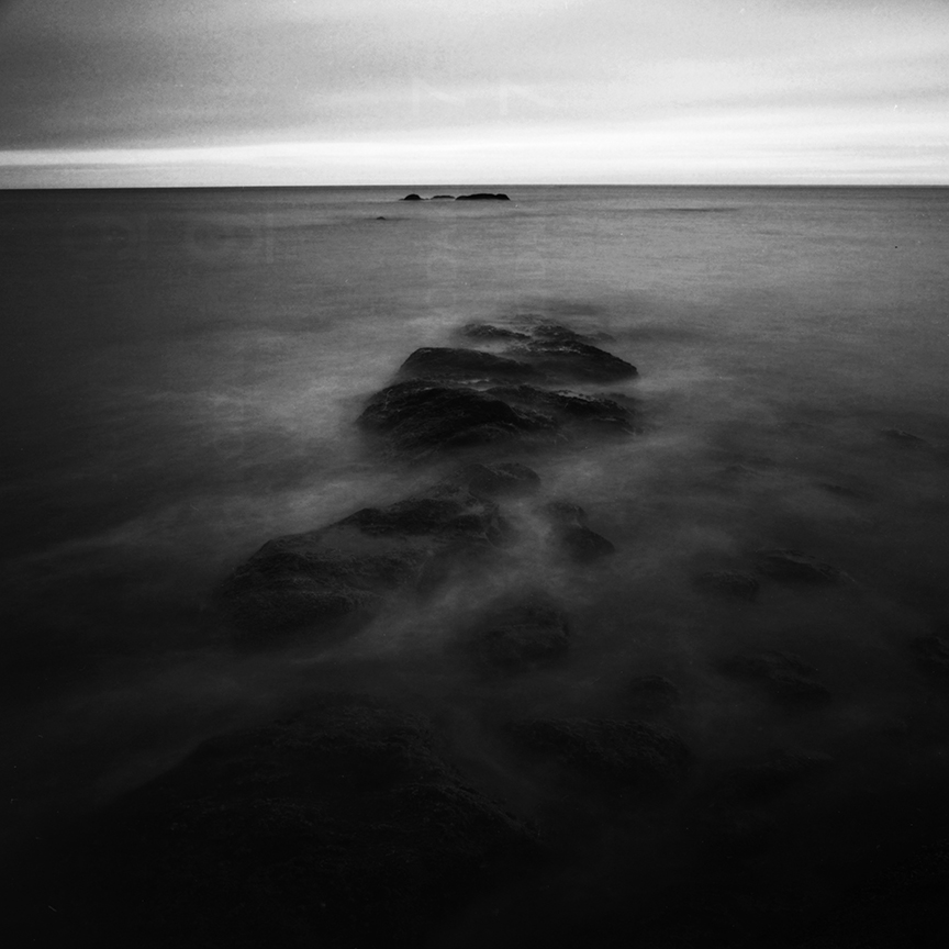

Ok so really embarrassed but maybe I loaded my film backwards. Camera is the Hasselblad film Kodak TMAX 100. I was looking at my film after developing it and i saw numbers and the word KODAK on the film. ouch ! So i scanned the film to post here and find out what happend. I think loaded it backwards but I have never done that before and don't know what to expect. All the shots were long exposures some as long as 2 plus minutes. The negative is very thin so under exposed because the paper was in the way maybe ? That is why i have the numbers of each frame exposed unto the film through the paper as well maybe ? What did you think happend ? I am hoping the scan show sup clearly on here.

It looks like you have one of the rolls with problematic backing paper. See this thread (among others): (there was a url link here which no longer exists)
Note the emulsion batches affected, and the email address for arranging for replacement of this and any other films within the problem batches.

No, I don't think you loaded it backwards - had you done that, I doubt you'd get an image even after 2 hours.
I think Matt is correct: you've unfortunately got a roll with the bad backing paper.

Yep the numbers on my film are in the bad batch. hey at least it wasn't me LOL I will go back when my FUJI Acros arrives Friday and reshoot.

No you have some of the bad batch of film, Kodak for some reason used a backing paper on some of there 120 roll film that caused a lot of problems, you will not get good images with this film.
Here is a cut and past from another post.
From Kodak:
The following Kodak Professional Film emulsion numbers may exhibit image problems, under some circumstances, only in 120 format roll film:
(Emulsion numbers can be found on the film box, the foil wrapper, and printed on the clear edge of processed film near frame number 11.
Kodak T-Max 400: emulsion 0148 roll 004 through emulsion 0152
Kodak T-Max 100: emulsion 0961 through emulsion 0981
Kodak Tri-X: emulsion 0871 though emulsion 0931
Any film with lower or higher emulsion/roll numbers should be free of any problem.
Please direct additional questions to: profilm@kodakalaris.com

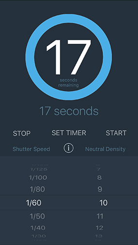

Mark my problem I have just a straight prism not the metered one on my Hasselblad. So I use my 35mm a Nikon f3 to get a base exposure and for example if the F3 is saying 1/60 with no filter i put that in the app and add the filter and it gives me the time to expose. Here is a screen shot from my iphone of the app. You can see that it gives a time of 17 seconds with the 10 stop ND filter. So maybe i need to add the reciprocity factor to that 17 seconds. I will try that. I sure appreciate your help this long exposure stuff is all new to me.

So if my exposure 17 seconds I will double that exposure to 34 seconds. I love testing and shooting and trying new things so this will be right up my geeky alley :smile: I will also bracket a few places under that 34 seconds and see what i get as well.

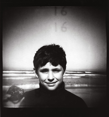

The best of luck and fun on the re-do! I have loaded my Calumet 6x7 roll film holder for 4x5 backwards once, I am trying to remember if it went on the take up reel backwards -- no mistaking the problem if so!
Sometimes having the numbers can work out. Unfortunately, Alex was only 12 -- would have been perfect if the numbers matched!
This is Tech Pan, long out-dated and not nicely kept for some of that life. Hence the numbers, probably. I just thought Tech Pan and an original Diana camera were just meant to be! After all, the camera and the film might have been made in the same year, give or take a few! Image below from a scanned silver gelatin print (7"x7").
