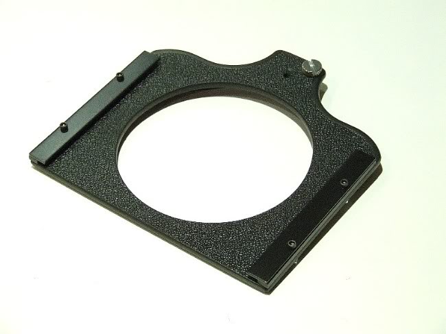

If you use some ingenuity, there are many ways to fashion a simple filter holder for under-the-lens filtering and a variety of ways to secure the holder to the lens, lens board or some other convenient mounting location on the enlarger.
You might consider using something like the following altered as necessary to fit your Fotar and scaled to accept whatever filter size you find practical to use:
http://store.khbphotografix.com/Under-lens-Filter-Holder-for-Omega-D5-and-D6-Enlargers.html
The following shows the Omega F lens mount for the 300mm Rodagon. The forked tab hanging down is for mounting a below-the-lens filter holder. Possilby you might make something like this as a mounting point for a filter holder on your Fotar enlarger.

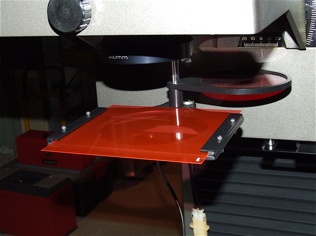

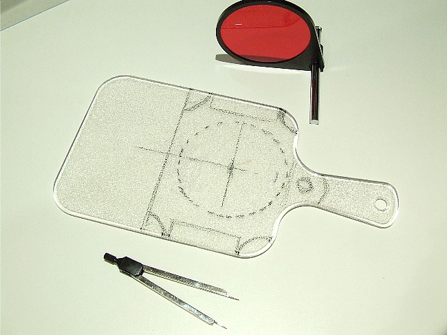

You need a pretty big filter holder for the 300mm Rodenstock. I made this holder for uncut 6x6in Ilford filters for use while I was looking for a dichroic head. After finding a head, I no longer use the filter holder. It so happens there is a bolt on the end of the Durst red filter holder to keep the red filter from falling off. I removed the chrome finger-bolt (and made a little keeper hole for it) and attached my filter holder to the bottom of the stalk with a longer bolt.
Clever! It gives me ideas! Thanks.

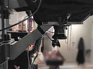

Thanks again Ian. All very useful information. I appreciate it. My Fotar set-up as attachment
I think that the filter thread on the 300mm Rodagon is 86mm. One solution is to make a box-like filter holder similar to the holder in the Ilford MG kit for smaller lenses. It can be made of card stock, folded as necessary and glued at any joints you need to make. Obtain an 86mm to 95mm or an 86mm to 105mm step-up ring.
Cut a hole in the top plate of the holder just big enough to admit the 86mm male thread and screw in the ring through the hole in the top plate of the holder and into the filter threads of the lens. The larger diameter of the step-up ring will support the holder under the lens. Make the box deep enough vertically so that it’s easy to insert/remove the filters. The opening in the bottom of the holder allows the filtered light to pass through to the enlarging paper and supports the filter.
http://www.bhphotovideo.com/c/product/39439-REG/Omega_421181_1_1_4_Cone_Lens_Mount.html
