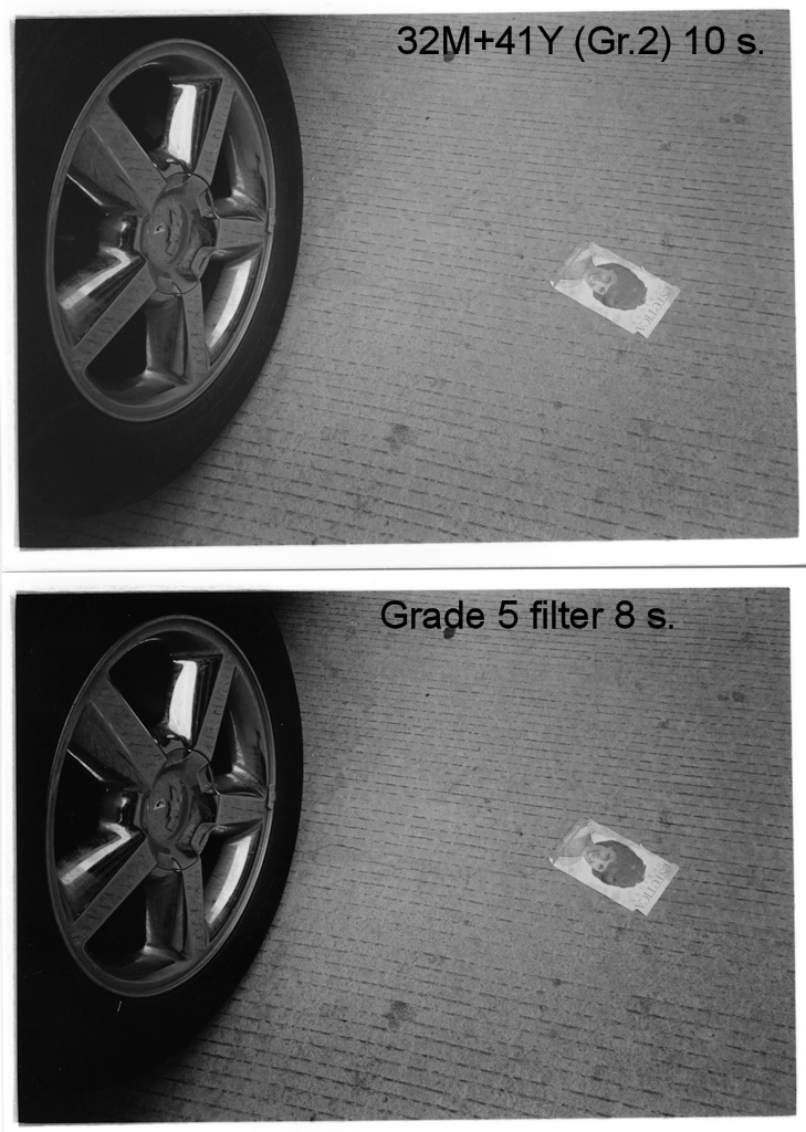

Here are some examples. I like the shadow detail in the top print (grade 2 dialed in) but the blacks aren't very black. The bottom print has blacker blacks and good contrast but the shadow detail is gone.

Your shot of the wheel in the garage, it looks like that might be a flat scene in the first place. If you could have known at the time to develop for approximately 12:30 minutes it would have helped this shot. Other scenes, in full sun, may print at Grade 2 with 9:45 minutes of development.
